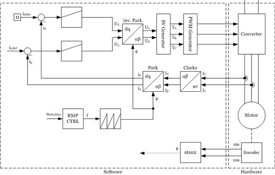

I recently closed the current control loop, where the angle signal is provided from the ramp generator and could speed up the motor to 6000rpm. PI controllers still have their default values.
In the next step, I wanted to replace the ramp generator with my calculated angle from the encoder (see attached h-file). Since I cannot use the graph tool, I created two arrays as my own datalog module to read the content in the watch-window.

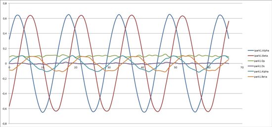

So I connected my angle signal to the park and ipark module and removed the angle generator. Then I started with Id,ref=0 and Iq,ref=0.1 and expected the motor to go faster and faster until I set Iq,ref back to 0. But instead I only reached approx. 2000rpm where the motor stopped accelerating. Increasing Id,ref led to even lower speed.
I logged some variables in this moment. Current values are normalized to +-200A. As far as I would say, the signal traces look good. The only thing making me wondering is the large amplitude of ipark.Alpha and ipark.Beta. Here is another screenshot showing all three scaled phase currents and a screenshot of the vallues in the watch window, when the data was logged:
So basically my problem is, that the motor won't speed up to more than 2200rpm. And I have absolutely no idea, why it doesn't. And I hope one of you guys can help me and can give me a hint what I can try.

    I think the problem has something to do with the correct excitation. Normally if you have no mechanical load your stator currents would be very low. However in my case I'm measuring a peak of 20A, resulting in a current feedback of normalized 0.1 (of 200A). So reference and feedback value of the Iq controller are equal, which limits the output of the controller to a certain level.  When I decrease the excitation, the rotor is spnning a little faster beacause stator currents decrease. So I think the motor pushes some reactive power through its windings. By the way, the DC shows a current of ~3A.

    I'm also trying to complete my FOC system with the configuration shown in the attached picture.

    "solve" might be the wrong term. I did a little workaround which helped me in my case. As I had shown at the very beginning of this topic, I aligned the measured signal with the ramp generator output. This led to the limited speed.
    So what I did then was to simply apply a constant zero as angle signal to the transformation objects. Then powered the motor and it aligned to its electrical zero degrees position. I read the current angle value from my sensor and set this as a constant offset to be substracted from the measured value. With this method I was able to run up to 7500 rpm what fully met my requirements.
