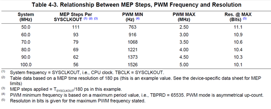

    If you look at this table in the TRM you can see that the HRPWM adds 6-bits for every example.
    I just carried it to the extreme of using the maximum ePWM period of 2^16 counts.
    I think you are correct with the number of ~5Hz.  I also should correct my previous number of ~1.5Hz, it should be ~1.5KHz.
    Check out this application note if you haven't already (should also somewhat apply to using the CPU timer as a DAC): spraa88a
    I am definitely not an expert on filter design, but I suspect that your performance requirements and cost/power/board space requirements are going to determine the topology and order of filter than you want; can I ask exactly what you are trying to accomplish with the DAC?
  • Hello Devin,
    Yes - I have seen that table - but that really isn't an equation other than adding 6 to the regular PWM resolution - maybe that is the equation.

  • John,
    Sounds like a challenging application.  Definitely outside of my expertise, but I will see what I can do to help.
    *If you want to calculate the additional HRPWM resolution, you can take the log2() of the number of MEP steps from this table.  At 90MHz, log2() of 62 gives you just under 6 additional bits of resolution.

  • Hello Devin,
    In the 90MHz example - the HRPWM effective bit rate would be -> Log2 62 + 10.3 ~ 16.25 bits?

  • That is the effective resolution at the max ePWM speed.  At the minimum speed, the base resolution will be 16 bits instead of 10.3 bits.
