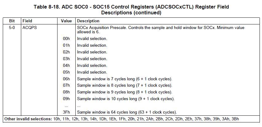

ADC Timing when ACQPS > 6
In the datasheet there is a timing diagram when ACQPS is 6.
| SOC 0 S/H - 7cyc | Gap - 6cyc | SOC 1 S/H - 7cyc | Gap - 6cyc | SOC 2 S/H - 7cyc |
                                  |          Conversion 0 - 13cyc       |          Conversion 1 - 13cyc       |
How is the timing when ACQPS is greater than 6?
Example: ACQPS == 8
Will the Gap between to samples  decreased to only 4cyc?
