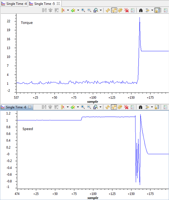

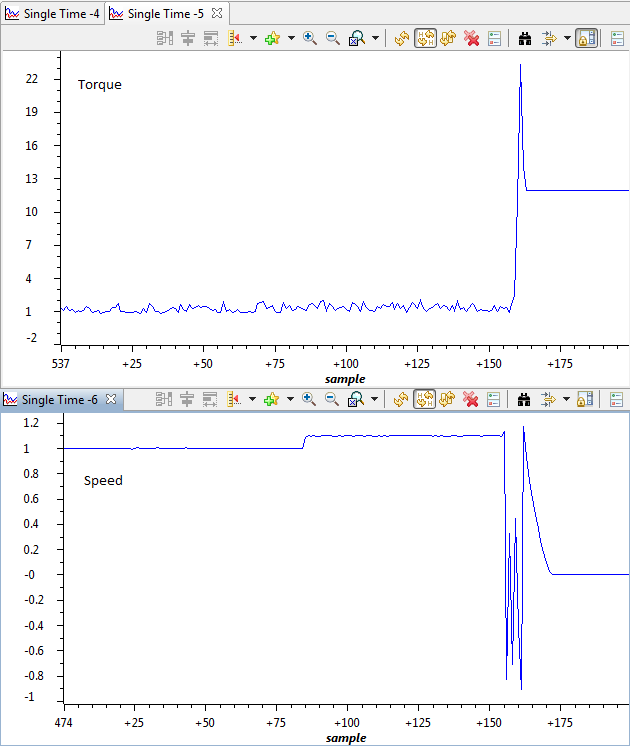

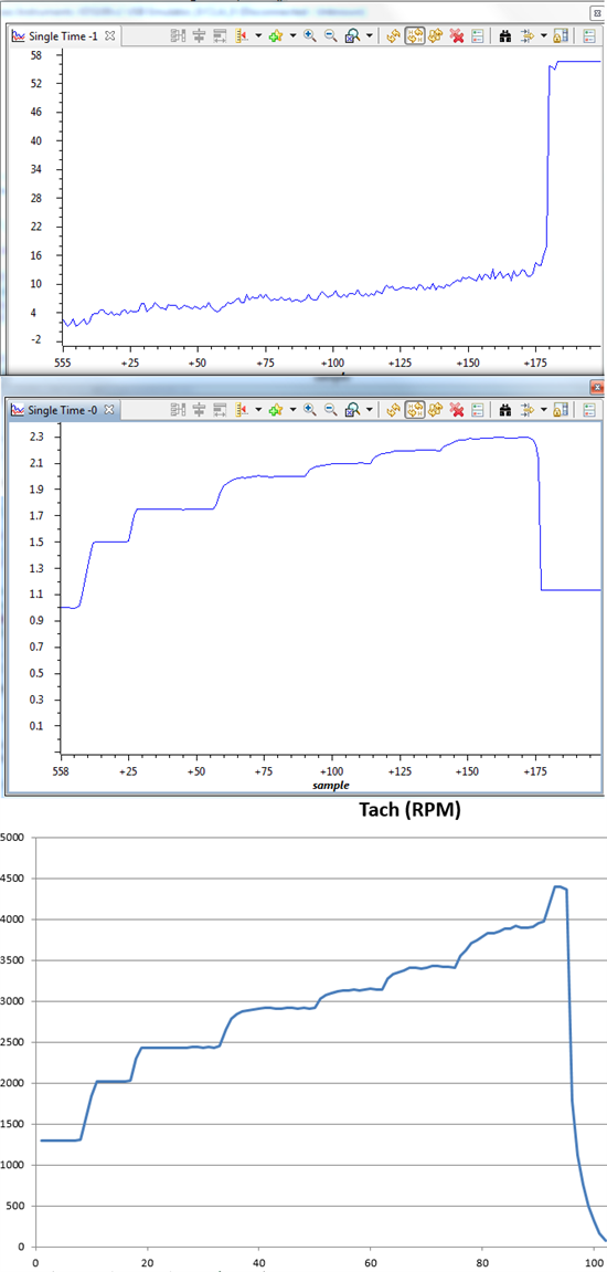

I am running the InstaSPIN-MOTION  project "proj_lab12" that came with Motorware on a custom hardware. I am running a 5krpm 22 pole motor with 2000 count incremental encoder. The system seems to perform pretty well in the speed range of 0 to 1.1krpm. But, every time I increase the speed reference beyond that, the system goes unstable and begins to rotate in the reverse direction and starts oscillating.
Here is a graph of "SpeedQEP_krpm" when the event occurs:
I have the "USER_IQ_FULL_SCALE_FREQ_Hz" at 1100, so I am sure that is not the issue. The encoder is rated for reliable output till 10krpm, so that doesn't seem to be the issue either.
Does this have anything to do with the SpinTAC bandwidth?
I would appreciate any ideas that might explain this behavior and help in fixing it.

  • I doubt this is a speed controller or scaling issue. First instinct would be to plot the angle being generated as an output from the encoder and input into the ipark module, looking for a discontinuity.

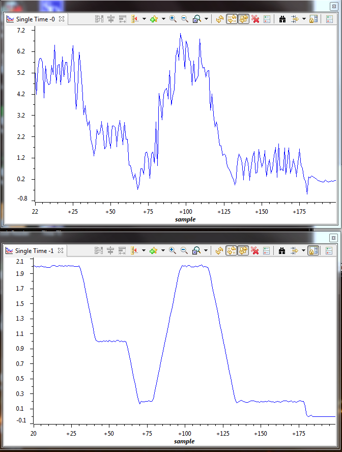

    Are you using Rs Recal to align the electrical angle?
    At the lower stable speed is the torque response as expected?

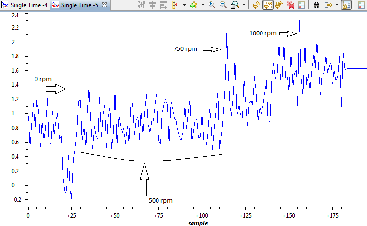

  • I tried to plot the encoder output (elecAngle), but it seemed too distorted, probably due to the the low-speed JTAG communication. I earlier ran the setup with a different encoder (an absolute encoder connected through SCI), and I ran into the exact same issue. That makes me think that encoder angle might not be the source.
    Yes, I think I am using Rs Recal to align the electrical angle, which seems to be the default method  in the project.

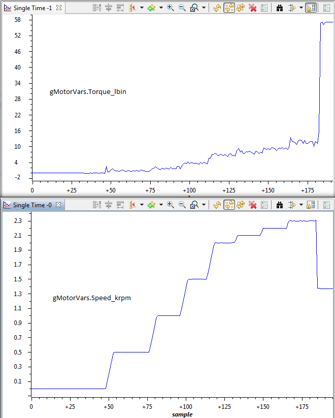

    At lower speeds of around 500-1000 rpm , the motor runs smoothly, but the plot of "gMotorVars.Torque_lbin" doesn't really make sense to me. Also, controller has difficulty staying at 0 rpm, where it begins to oscillate. The rotation isn't smooth till the SpeedRef is above 300-400 rpm. I have a propeller attached to the rotor, and the zero speed performance does improve when the props are not attached.
    gMotorVars.Torque_lbin:
    -Tamil

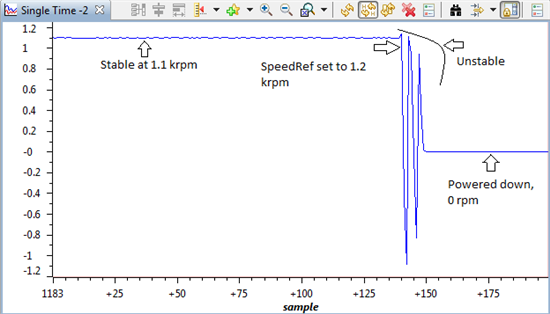

  • UPDATE:
    After observing more closely, I found out that when the said instability occurs at 1200 rpm command, the speed of the motor actually raises up rapidly in reality, but it is the "SpeedQEP_krpm" plot that shows the speed as reversing and oscillating. The "gMotorVars.Torque_lbin" plot reflects the rapid increase in speed and torque.
    I wonder if the issue is due to some variable overflowing.
    -Tamil

    I was curious to know if the issue indeed was occurring at around 2300 RPM, so I added an external tachometer to my setup and found out that the real speed was very different from the estimated speed. I have attached the graphs of the Torque (lb-in), Estimated speed (krpm) and speed measured from external tachometer (rpm). The issue now seems to be happening at a real speed of 4400 RPM, which is around 800 elec. Hz, although the FAST estimator still believes the speed to be 2300 RPM at that point.
    I wonder why there is this huge inconsistency in the estimated speed. The difference between estimated and measured speed was around 100 RPM when the speed was 500 RPM, and it slowly increased, almost linearly, to a difference of 2000 RPM when the speed reference was 2200 RPM. Probably whatever is causing this error is also the cause behind the runaway issue that I am seeing.
    Any thoughts?

  • This is a custom motor that we build, so by datasheet values I meant values measured with a LCR meter. The motor windings are Y connected and the line to line inductance I measure was 14uH, which is the value I am using in user.h. The motor ID was not very consistent, but was always higher by an order or two of magnitude.
    Here is my user.h:2425.user.h
    -Tamil
  • Our inductance value is line to neutral, so you at least need to halve your measured line to line value.  Under what conditions did you measure using the LCR?
  • I see some other issues in your user.h as well.
    Your clocking and decimation is off. You are trying to clock everything at 30 KHz, that's too much in an interrupt, you are likely overflowing (or very, very close to doing so).
    Also, I'm not even sure if 30 KHz is high enough PWM for such a high Isc motor.
    Isc = Flux / 2pi / Ls = 341 A if your Ls is correct, 682A if it's really 7uH.
    With such a low Ls I would try setting PWM to 60 KHz, use PWM decimation of 3 to make 20 KHz effective inside the controllers, (20) for speed and trajectory.  This will use over 60 MIPS of the processor, so if you need to reduce you can start first with
    USER_NUM_CTRL_TICKS_PER_EST_TICK       (2)
    to reduce the FAST estimator to 10 KHz effective.
    I'm using the Joby_1S motor parameters BTW, I assume that's the motor you are using.
    Your R/L = 50 Hz.  Your Rs seems MUCH too low.  Even if your Ls should be 7uH you're still looking at 100 Hz R/L as your maximum frequency.  With a 22 pole motor that's only 545 RPM.  There is no possible way this motor is designed to do 5 kRPM (916 Hz).
    This is much too low for a 75A motor:
    #define USER_MOTOR_RES_EST_CURRENT      (1)
    Does it even start to spin during the EST_RampUp state?
    Your Rs has to be higher than 0.0007 ohm.  It just has to be.
    And looking at your ADC Voltage and filter it looks like you are using the design from the DRV8312...but you have designed the drive stage for 100A similar to the DRV8301?
    I have some doubts about your ADC_FULL_SCALE values, and your associated IQ values are certainly incorrect. Assuming your ADC values are correct (which I'm not sure they are) you can set your IQ values to
    USER_IQ_FULL_SCALE_VOLTAGE_V      (BUS VOLTAGE + ~15%)
    ex (60)
    USER_IQ_FULL_SCALE_CURRENT_A  (USER_ADC_FULL_SCALE_CURRENT_A    /   2  + a few AMPs)
    ex (110)
  • Thanks for your comments Chris.
    The inductance value was measured at no load, zero speed, with no excitation.
    The Rs value in my user.h is definitely wrong as you pointed out. The value I got from LCR meter was around 7mOhm line to line, which would be around 3.5mOhm line to neutral. I think I had 0.0007 when I was playing with the values but forgot to change it back, because the Rs recal estimated values were pretty close to my measured values.
    I updated the Ls and Rs values to 0.000007 and 0.0035 respectively.
    I changed the decimation to 30kHz PWM, 10KHz ISR and CTRL and 1KHz Speed and Trajectory.
    Earlier I had USER_IQ_FULL_SCALE_VOLTAGE_V and USER_IQ_FULL_SCALE_CURRENT_A  at 60 and 100 respectively, but I changed it to see if that solves my problem, which it didn't. Now I have it back to 60 and 110 as you suggested.
    I haven't been able to see any difference in the performance yet.
    I have run this motor up to 6000 RPM with an off-the-shelf controller, so I think the issue is probably not with the motor.
    I think the issue could be with my ADC scaling and offset. My power stage is very similar to DRV8301, except that I am using hall-effect based current sensors on each phase. The sensors are bidirectional 200A sensors, with 0V corresponding to -200A, 1.65V corresponding to 0A and 3.3V corresponding to +200A.
    For voltage sensing, I use a simple resistor divider with full scale voltage of 66.32V and filter pole at 714.15 Hz, based on the design in SPRUHJ1C section 5.2.3 and 5.2.4. My standard bus voltage is 48V.
    I have set "Flag_enableOffsetCal" to 1, but the values in the "I_bias" and "V_bias" under "gMotorVars" object remain at zero. However, the values in the "drv" object seem to get updated during startup. The "offset_I" values are around 0.0005 and "offset_V" values are around 0.4, which don't look correct to me. I would expect offset_I to be around 1.65 and offset_V to be around zero. Am I right? If these values are not correct as I think, how do I fix it?
    Tamil
  • Your R/L is still only 500 Hz, which is not large enough to support 1KHz operation.
    For your off the shelf controller is it open loop V/Hz? Does it require any motor parameter data?
    What is the polarity of your ADC current measurement?  See the UG section 5.2.2 regarding DRV_updateAdcBias()
    Also, if your current sensors measure +/-200A then your
    USER_ADC_FULL_SCALE_CURRENT_A should be (400)
    and
    USER_IQ_FULL_SCALE_CURRENT_A should be (210)
    it seems like your
    USER_IQ_FULL_SCALE_VOLTAGE_V (66.32) and
    USER_ADC_FULL_SCALE_VOLTAGE_V (48)
    should be correct.
    "I have set "Flag_enableOffsetCal" to 1, but the values in the "I_bias" and "V_bias" under "gMotorVars" object remain at zero"
    Which lab are you using? Not all labs do a "get" and update the gMotorVars for this structure.  Just look at the structures like:
    drv.adcBias.V.value[0]
    these are the values that would need to go into your user.h for the
    #define   V_A_offset
    etc.
    The offsets are scaled off the scale factor for current and voltage, so they are NOT 1.65 and 0 at all, and they change if you change your IQ_V or IQ_A.
    Your values are certainly wrong.
  • Probably my Rs measurements are not accurate. The off the shelf controller that I mentioned is a RC hobby ESC. It doesn't require to know any motor parameters to run.
    I have changed USER_ADC_FULL_SCALE_CURRENT_A  and  USER_IQ_FULL_SCALE_CURRENT_A as per your recommendation.
    For USER_ADC_FULL_SCALE_VOLTAGE_V , I think 66.32 would suit my setup better, I have the same resistor network as Figure 5-7 in UG (SPRUHJ1C). I guess then I would have to set USER_IQ_FULL_SCALE_VOLTAGE_V  a bit higher than 66.32. Isn't it?
    I have modified V_A_offset ,etc. in user. h based on drv.adcBias.V.value[0], etc. as you suggested. That doesn't seem to have any effect either.
    The offset values are  around 0.95 for current and around 0.36 for voltage. If the offset is scaled, what values should I be expecting?
    One aspect that is different in my setup with respect to current sensing is that I am measuring the current not at the shunt, but at the phase. I.e., the terminals of my current sensor are attached between the source of high side FET/Drain of low side FET and the motor terminals. Current flowing from the FETs to the motor is measured as positive. Will this need any modification in my software configuration?
    -Tamil
  • Sorry, I switched the values, corrected
    USER_IQ_FULL_SCALE_VOLTAGE_V (48.0) and
    USER_ADC_FULL_SCALE_VOLTAGE_V (66.32)
    The IQ Value does not have to be larger than the ADC value in the case of voltage.  It should be as small (minimum flux measurement required * 0.7 * Estimation Frequency) or as large (Flux in V/Hz & Maximum Hz you will attempt to run + headroom) as required for flux measurement.
    When using phase current measurements you will want to follow the Negative Feedback circuit example of 5.2.2.2
    "The offset values are  around 0.95 for current and around 0.36 for voltage. If the offset is scaled, what values should I be expecting?"
    This is reasonable
  • I updated USER_IQ_FULL_SCALE_VOLTAGE_V and USER_ADC_FULL_SCALE_VOLTAGE_V now.
    As said in the Negative Feedback example of 5.2.2.2, I have defined DRV_updateAdcBias function like below:
    //! \brief Updates the ADC bias values
    //! \param[in] handle The driver (DRV) handle
    inline void DRV_updateAdcBias(DRV_Handle handle)
    uint_least8_t cnt;
    DRV_Obj *obj = (DRV_Obj *)handle;
    _iq bias;
    // update the current bias
    for(cnt=0;cnt<DRV_getNumCurrentSensors(handle);cnt++)
    bias = DRV_getBias(handle,DRV_SensorType_Current,cnt);
    bias += OFFSET_getOffset(obj->offsetHandle_I[cnt]);
    DRV_setBias(handle,DRV_SensorType_Current,cnt,bias);
    // update the voltage bias
    for(cnt=0;cnt<DRV_getNumVoltageSensors(handle);cnt++)
    bias = DRV_getBias(handle,DRV_SensorType_Voltage,cnt);
    bias += OFFSET_getOffset(obj->offsetHandle_V[cnt]);
    DRV_setBias(handle,DRV_SensorType_Voltage,cnt,bias);
    return;
    } // end of DRV_updateAdcBias() function
    I do not have an amplifying stage, since the sensor has it built-in and gives output scaled to  0-3.3V.
    Unfortunately I am still facing the same problem of erroneous estimated speed.
    -Tamil
  • Is there any documentation explaining how the bias offsets are calculated and how they are used? Although you say the values that I get are reasonable, they don't make sense to me. I would like to know more about it.
    -Tamil
  • bor the bias / Offset see ch 6.5.2 where it is thorouglh explained and calculations are shown.
  • Thanks, that helped. The offset values make more sense now and seem to be right.
    But I still haven't been able to solve the original issue of the controller becoming unstable at estimated speed of around 2300 RPM and the huge difference between the estimated and measured speed.
    -Tamil
  • Let me correct myself on the Bias
    if a current comes out of the motor, and creates a voltage in the ADC of 1.65V to 3.3V, this means we have a positive current feedback. You would need this configuration:
    In DRV_readAdcData in drv.h:
      // convert current A
      // sample the first sample twice due to errata sprz342f, ignore the first sample
      value = (_iq)ADC_readResult(obj->adcHandle,ADC_ResultNumber_1);
      value = _IQ12mpy(value,current_sf) - obj->adcBias.I.value[0];      // divide by 2^numAdcBits = 2^12
      pAdcData->I.value[0] = -value;
      // convert current B
      value = (_iq)ADC_readResult(obj->adcHandle,ADC_ResultNumber_2);
      value = _IQ12mpy(value,current_sf) - obj->adcBias.I.value[1];      // divide by 2^numAdcBits = 2^12
      pAdcData->I.value[1] = -value;
      // convert current C
      value = (_iq)ADC_readResult(obj->adcHandle,ADC_ResultNumber_3);
      value = _IQ12mpy(value,current_sf) - obj->adcBias.I.value[2];      // divide by 2^numAdcBits = 2^12
      pAdcData->I.value[2] = -value;
    in DRV_updateAdcBias function in drv.h:
          bias -= OFFSET_getOffset(obj->offsetHandle_I[cnt]);
    I still think your motor parameters - especially inductane - are incorrect, that's the only way the estimator would create such a difference and instability.
  • I measure current at the phase output and current going into the motor creates 1.65 to 3.3V. Would that mean I have negative feedback? Then I guess the default definitions in drv.h would work?
    I am running a custom high current motor with very low inductance. I confirmed with the person who designed the motor that the expected winding inductance is in the10-20 microhenries range. So I think the inductance values I am using are pretty close to the real value. Does the performance of FAST depend a lot on motor parameters?
    I am still not sure if I got the offset correct. Just to confirm, after enabling the controller, the values in "drv.adcBias.I.value" and "drv.adcBias.V.value" get updated and I must use those values in user.h for future runs. Am I right? (I am mainly running lab 5e and lab 12).
    The dcBus value under the adcbias seems to be erroneous, showing up at 91V sometimes or a negative voltage sometimes, while the actual bus voltage is 48V. The voltage offset bias value seems too low, at ~0.1. I checked the actual voltage across sensor resistor and it seems to be correct. I am not sure why the ADC values are off. I wonder if that is the case with the current measurements too. Is there a way to plot the current measured?
    I updated the decimation as per your recommendation and I have managed to get up to higher speeds in the sensored project (lab 12). At 18kHz PWM, 6KHz ISR, 3kHz CTRL, EST, SPEED and TRAJ, I could go up to 3900 RPM. The estimated speed was off by 200-300 RPM almost throughout the range.
    The graph of the torque estimate doesn't look very smooth and seems very unstable. I wonder what could cause this instability.
    Here is a graph of Torque estimate(top) and measured speed(bottom):
    -Tamil
  • Tamil,
    Considering you have custom HW I think you have some issues with the voltage and current signals coming to the ADC pins.  I would spend some time debugging and verifying your signal conditioning and scaling first.
    "I measure current at the phase output and current going into the motor creates 1.65 to 3.3V. Would that mean I have negative feedback?"
    I still think you have positive feedback. A maximum positive current creates 3.3V, correct?
    "I am still not sure if I got the offset correct. Just to confirm, after enabling the controller, the values in "drv.adcBias.I.value" and "drv.adcBias.V.value" get updated and I must use those values in user.h for future runs. Am I right? (I am mainly running lab 5e and lab 12)."
    Correct.
    "So I think the inductance values I am using are pretty close to the real value. Does the performance of FAST depend a lot on motor parameters?"
    FAST is less dependent on the parameter variation than other observers, but is highly dependent on quality of the voltage and current measurements in the system. And remember, there is no single inductance value for a motor. The inductance is a factor of the current (load) and speed and will change.  The issue with very low inductance motors is that the short circuit / ripple current is very high, so several things happen: 1)  it is very difficult to get good current values through a shunt approach, as the current doesn't behave linearly during the sampling window 2) PWM control is more challenging as the current is being switched more rapidly, often heating up the motor; many of these motors are really only designed to be run at high speed when their motion can self cool, at low speeds they can overheat easily.  Many low inductance motors use a control scheme where they are commutated full out and only the bus voltage is varried to control the maximum speed.
    "The dcBus value under the adcbias seems to be erroneous, showing up at 91V sometimes or a negative voltage sometimes, while the actual bus voltage is 48V. The voltage offset bias value seems too low, at ~0.1. I checked the actual voltage across sensor resistor and it seems to be correct. I am not sure why the ADC values are off."
    All of things point to something going very wrong with getting good voltage/current measurements into your system
    "At 18kHz PWM"
    For uH type inductance you will need to PWM much higher than this. I suggest looking at 45-70 kHz range.
    And you want to make sure your CTRL kHz > 10x your Maximum Hz
    "The graph of the torque estimate doesn't look very smooth and seems very unstable. I wonder what could cause this instability."
    Bad voltage measurements. Bad FOC control. Possibly a bad filter pole Hz to Max_Frequency ratio.
  • Chris,
    Thanks for your comments.
    In your previous post, you had mentioned that if a current comes out of the motor, and creates a voltage in the ADC of 1.65V to 3.3V, we have a positive current feedback. Whereas, I have the sensors in such a away that 1.65 to 3.3V is created when the current is going into the motor. Here is a small drawing illustrating my setup:
    Would you still call this a positive feedback? I actually tried changing drv.h for positive feedback, but I couldn't run the motor then. I am able to run the motor only with the setting for negative feedback.
    I did some tests to verify my current and voltage signals. Here is a chart comparing the current signal at  the microcontroller's ADC pin (top) and the current measured using a current probe (bottom):
    It looks pretty accurate to me.
    For voltage feedback, I am using the same circuit suggested in user guide Figure 5-7. Here is the voltage signal (top) and actual phase voltage(bottom) at 1000 rpm:
    I am looking at max. operating electrical frequency of around 916.67 and the voltage filter pole is at 714.15Hz. Is this good enough or should I change?
    Regarding the wrong measured "dcBus" value, I checked the voltage feedback signal(+2.4V) and it seemed to properly reflect the bus voltage of +48V. However, the controller shows a totally wrong value, of around-31V. This seems to be a problem with the firmware. I have the USER_ADC_FULL_SCALE_VOLTAGE_V set properly to 66.32 and voltage offsets updated properly, to around 0.47. I am not sure why the value is still wrong. I was curious and checked the dcBus value on the DRV8312 kit while running the 24V kit bldc motor in lab 5e, and the value was shown to be around -27, while it should have been +24V. However, I could run the small motor even up to 5000 rpm without any issue.
    Is there a way to plot the voltage and current measurements as read by the controller? The hardware signals look fine to me, but something seems to be wrong in the way they are translated in the firmware.
    Shouldn't the controller be less dependent on the current and voltage measurements in lab 12, since it is getting the position values directly from the encoder?
    Regarding the PWM & CTRL frequency, if I consider 45kHz PWM and CTRL frequency above 10kHz, the CPU utilization, 100 % * (DRV_acqAdcInt + DRV_readAdcData + Ctrl_run + DRV_writePwmData + Ctrl_setup + STVELCTL_run + STPOSCONV_run) / 90Mhz * 45kHz seems to be way over 100%. Am I missing something in the calculation or is it not possible to run at such high PWM frequencies? Will I have to disable the estimator and use only the encoder data to achieve this?
    -Tamil
  • Your voltage filter is fine.
    You need to investigate the dcBus value, something is very wrong there.  How are you getting negative values?
    gMotorVars.VdcBus_kV = _IQmpy(gAdcData.dcBus,_IQ(USER_IQ_FULL_SCALE_VOLTAGE_V/1000.0));
    "Shouldn't the controller be less dependent on the current and voltage measurements in lab 12, since it is getting the position values directly from the encoder?"
    In lab12 you still need good current values for your Clarke and Park to give you Iq and Id.  You are correct that the phase voltage values are no longer required if you aren't using FAST feedback in your system.
    "Am I missing something in the calculation or is it not possible to run at such high PWM frequencies?"
    Yes, you are very much missing something.  All of the control components are not running at 45 kHz, only the PWM. That is the point of using hardware and software decimation. As an example:
    PWM runs at 45 Khz, but if you use the (3) it only kicks off the ADC every 3rd event, for 15 kHz effective.
    You can then run your main interrupt and current controller at 15 kHz, and you can run the estimator at 7.5 kHz by using (2), or in your case in lab12 you don't need to run it at all.  Then use (15) for the speed and trajectory to put them at 1 kHz effective.  The SpinTAC components will run at 1 kHz then.
  • Thanks Chris.
    What is the recommended voltage filter pole Hz to max. elec. Hz ratio?
    I think I was looking at the wrong variable - "drv.adcBias.dcBus". I now checked "gAdcData.dcBus" value and it seems to be correct.
    How would I calculate the CPU utilization for values of ISR ticks = 3? Section 10.7 seems to provide values only for ISR ticks =1.
    I will try running the controller at 45kHz with the decimation as you suggested and get back on how it performs.
    Tamil
  • see ch 5.2.4 for the filter design
    "The voltage filter pole is needed by the FAST estimator to allow an accurate detection of the voltage
    feedback. The filter should be low enough to filter out the PWM signals, and at the same time allow a high
    speed voltage feedback signal to pass through the filter.
    As a general guideline, a cutoff frequency of a few hundred Hz is enough to filter out a PWM frequency of
    10 to 20 kHz. The hardware filter should only be changed when ultra high speed motors are run, which
    generate phase voltage frequencies in the order of a few kHz."
    In general, you want this slightly higher than your highest motor frequency.
    For the processor loading,
    first, review figure 10-1 and understand the decimation rates that are important.
    PWM is the frequency of the PWM timer / update
    PWM_TICKS_PER_ISR sets the hardware divisor rate from the PWM frequency for starting the ADC conversion in a PWM event; divide by 1, 2, or 3....when the ADC is done converting it sets the main interrupt.  So PWM / PWM_TICKS_PER_ISR gives you the main ISR rate for acknowledging and reading the ADC interrupt.
    You then dvide this rate by ISR_TICKS_PER_CTRL, which  gives you an effective CTRL rate. This is where feedback and feedforward calculations can take place.  There are four components of the CTRL system: Estimator, Current (which includes the inverse transforms through the duty cycle calculations), Speed, and Trajectory.  Each can be decimated off of the CTRL rate.
    Most common would be to:
    Decimate the EST to keep an effective rate of 2.5 to 10 KHz.
    Decimate the Speed and Trajectory to keep an efffective rate of 1 KHz.
    While the current can also be decimated, if you wanted it to run slower you should just change the effective rate of CTRL.  There is no sense in having CURRENT run slower than CTRL, it will just add to wasted interrupts.
    In Table 10-4
    it looks like the TRAJ and SPEED aren't even being taken into account. They are very low CPU count operations and are typically decimated to much slower rates (like 1 KHz).  It looks like the CPU count number is just CTRL (including CURRENT at the same rate) and then Estimation, showing effect of decimating Estimation by 1, 2, or 3.
    I'll create a bug report to see if some clarification can be added on those points...
  • I think voltage filter pole frequency was the problem. I increased it to around 1100 and I was able to go up to 5000 RPM, which is close to the rated speed of the motor.
    However, the big error in the estimated speed continues to be the same way. When the encoder speed is 5000 RPM, the estimated speed is around 3600 RPM. I have individually checked my current sensors on a resistor bank and the sensor output seemed to be pretty linear throughout the range. Also, the voltage and current sensor signals to the microcontroller ADC pins seem to be clean and at the right levels. I wonder why the estimated speed is still way off.
    When I tried running the setup at 45kHz, the switching losses seemed to increase a lot in my MOSFETs, so for the same current input, I was getting a lower speed. I am paralleling MOSFETs to increase the current handling capability, which is now affecting the maximum speed at which I can switch comfortably. The switching losses are low only up till 20-24kHz.
    -Tamil
