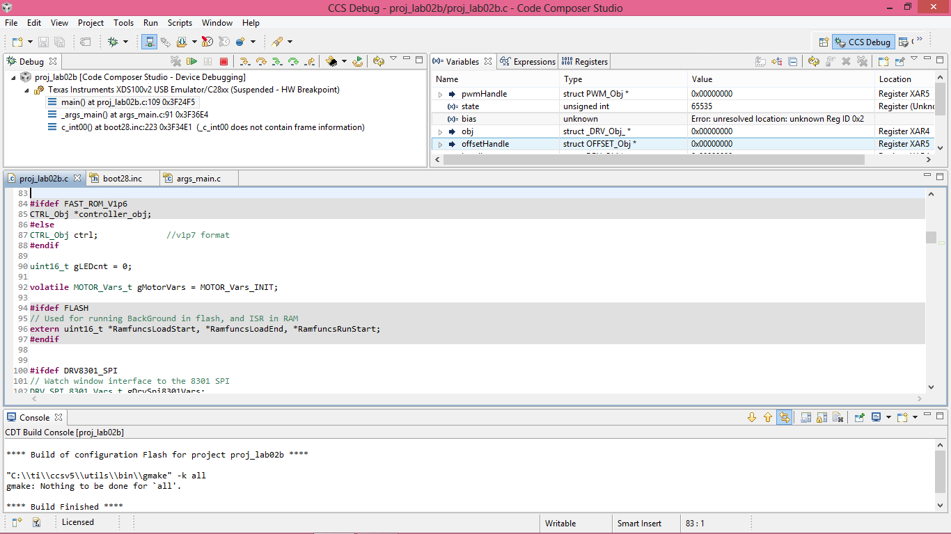

 .I require aid in my development of a drive based on instaspin foc.
For that purpose i ve purchased launchpad tms f28027f with booster kit.
I currently am going through labs 1 to 12 .
while executing these labs i am getting errors . Can u please poit mi in the right direction.
Pushkar.
PS i am enclosing the debug screens of both expts.
for lab 1
  • Are you talking about the
    Error: unresolved locations...
    in your Variables tab for "bias"?
    Yes, I have the same.  "bias" variable is referenced through the stack, so the compiler doesn't assign an actual memory location to this internal variable.  Just keep moving on in the labs and make sure you are using the Expressions tab to interact with variables (and/or us the Universal GUI).
