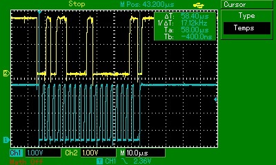

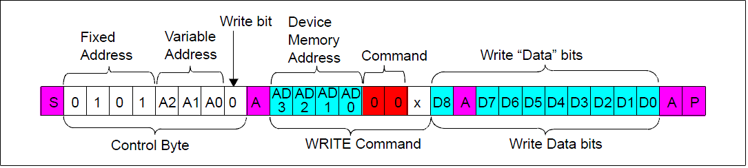

I have some problems to comunicate with my digital pot in I2C (Microchip MCP4552).
I work with a custom board, I can already comunicate with an I2C FRAM (FM24V10-G) and an I2C DAC (TI DAC8574)
First what I want to do is initiate the pot by setting the pot to the minimum. To do that I have to write $00 in the data byte
This is the code :
Uint8 i2cPOT_WriteData(Uint8 UI8_I2CAddress, Uint8 UI8_Mem_Address, Uint8 UI8_CmdOp,  Uint16 UI16_PotCmd){
                      Uint8 UI8_Cmd_Byte = (UI8_Mem_Address << 4);
                      UI8_Cmd_Byte |= (UI8_CmdOp << 2);
                      UI8_Cmd_Byte |= (UI16_PotCmd >> 8);

This is what I have ! As you can see the TMS320 write only 2 bytes and no stop bit !! What I'm doing wrong ?
Thank you for your help.
Regards, Nicolas
