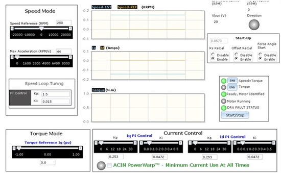

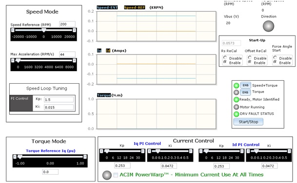

I'm using DRV8301-HC-EVM Rev D and the F2806x ISO-controlCard to evaluate instaSPIN on one of our 24V PMSM motor.

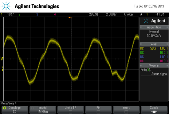

With the GUI pre-compiled program, my motor run a 4740RPM (nominal speed) until 18V when overmodulation is set to 1 and until 17V when overmodulation is set to 1.15 (and i can see a regular distorsion on the current waveform). Below this voltage, i can't reach 4740RPM but it is still running.

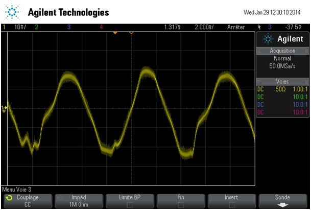

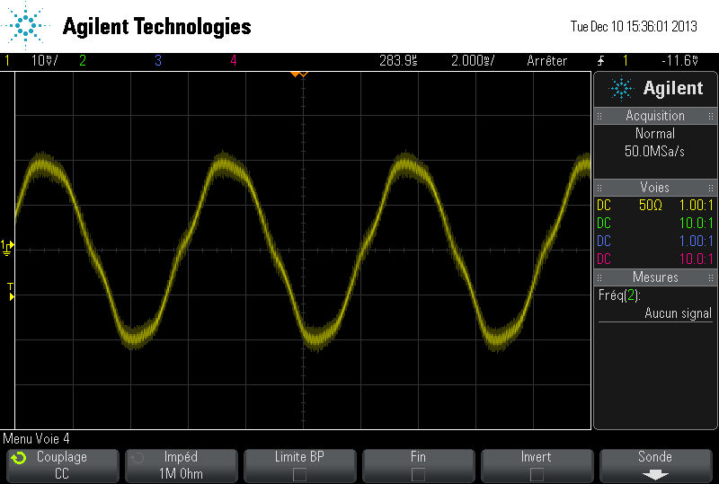

But with the lab example (lab03b), when the voltage reach 20V, there is some spurious distorsion on the current waveform :
At 21V :

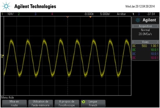

At 19.8V :
I have also add 1us dead time but the problem was present before I add the dead time.

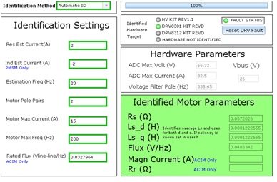

There is sometimes some little difference on RS and LS but with exactly the same, there is no change. I also adjust Kp and Ki to have exactly the same but there is no change.
The GUI parameters are :
And now my user.h....

There must be a difference but i can't find it because we don't have the source parameter of the GUI application.
Thanks if someone can help me.

  • Manu,
    First try using lab10a where you can change the Modulation and are using the latest SVPWM.
  • to be clear on this topic, lab10a is where the current reconstruction algorithms are first applied (and necessary).
    The GUI uses Firmware that is over 1yr old, and as you see it's basically all the features lumped together (torque mode, modulation, field weakening, motion profiles, SpinTAC, etc).  It's too hard to keep up to date as we make incremental improvements, so the GUI firmware is "frozen".
    We have made several changes to the functions, especially the Modulation starting in release _09.  These are part of proj_lab10x, and if you want to use a higher modulation than 1 (and most will) you should probably start your own project based on proj_lab10x to take advantage.
    There is one remaining "hole" in this modulation update that we have recently solved, and it looks like you have found it.  At the exact spot in the waveform of the glitch is where the current sampling windows close for at least one of the currents.  That's usually fine and we can sample the other two phases.  But what happens is that the un-samplable phase causes cross-coupling switching noise into the other two phases.  The cross-coupled noise is exactly at the center of the sampling point for the other two.
    We just finished an updated current regen algorithm that always stays away from non-sampled switching events.  Still, there are instances when only one current can be sampled.  For this case, we used a filtering scheme and now  have a smooth current sample all the way to 4/3 overmodulation.  This solved all the modulation problems we have seen and this solution is now running reliability / longevity testing in a real application.  We'll be adding this to MotorWare in one of the next releases, either _12 or _13.
  • Thanks for the answer,
    The problem is not present with the "old" GUI even if I use overmodulation (1.15max, there is a driver fault if i go over), and the example I use (lab3) doesn't use overmodulation. I have try lab 10 but i did'nt focus on this problem so I will try again today and I will let you know.
    Regards.

  • Manu,
    I noticed this in your user.h
    #define USER_NUM_PWM_TICKS_PER_ISR_TICK 2//(3)
    please change to
    #define USER_NUM_PWM_TICKS_PER_ISR_TICK (2)
    this is putting the main interrupt at 20 kHz / 2 = 10 kHz.  Just FYI you have your speed and trajectory at (15).  You may want to set these to (10).  It probably doesn't hurt to have them at (15), but doesn't help much either.
    So, to summarize the original problem:
    With the GUI
    • everything runs fine at rated speed and 24V.
    • it keeps rated speed down to 18V and modulation of 1.0
    • at 17V modulation is increased to 1.15 to keep speed, and waveform has a normal distortion
    with lab3b
    • with modulation at 1.0 (only modulation possible in lab3b), as voltage is reduced below 20V you start to see a spurious current distortion
    is that correct?
    Try lab10 and let me know results

    Yes you are right.
    please change to
    I don't understand the difference but I will try.
    I will also try lab10 but i'm not sure It will be done today.
    Many thanks.
    Emmanuel
  • Hi, I try lab10 as you advise me and I also made the others change. So with lab10 it is... different... The spurious current distorsion begin at a higher voltage (22.5V) but it seems lower than the distorsion I have with lab03. I also try to increase overmodulation to 1.15, so overmodulation works correctly (speed is correct at 17V) but it doesn't change the distorsion. Others change doesn't seems to impact the current distorsion. Regards. Emmanuel
  • Manu,
    You can try increasing your PWM frequency up to 45 kHz and current controller to 15 kHz and see if it helps at all.  I don't suspect it will, but it's worth trying.
    #define USER_PWM_FREQ_kHz                (45.0)
    #define USER_NUM_PWM_TICKS_PER_ISR_TICK        (3)
    #define USER_NUM_ISR_TICKS_PER_CTRL_TICK       (1)
    #define USER_NUM_CTRL_TICKS_PER_CURRENT_TICK   (1)
    #define USER_NUM_CTRL_TICKS_PER_EST_TICK       (1)
    #define USER_NUM_CTRL_TICKS_PER_SPEED_TICK  (15)
    #define USER_NUM_CTRL_TICKS_PER_TRAJ_TICK   (15)
    I suspect it is more likely that you are running into two issues
    1. The hardware layout for current sampling isn't ideal. The traces are quite long from the OPA to the ADC pin, so it's picking up noise and there is some cross coupling of the switching going on.

    Bad news on my current waveform:
    I have receive the F28027F controlCARD, to evaluate InstaSpin with the TMS320F28027F because it is the CPU I will use on my personnal board and i start to run programs....
    With this control board, I discover the same problem than previously with the F28069, I have current distorsion when my input voltage reach 20V.
    I have solve this distorsion with 28069 control card by reducing PWM frequency from 20k to 16kHz. But the problem was not present when I was using the GUI (see my firt posts).
    My user.h are the same, only the USER_SYSTEM_FREQ_MHz is different (60MHz vs 90MHz).
    I feel that there is a timing problem, perhaps with ADC wich will be too long when I reach modulation around 1(overmodation is not activated), and so the current reading will be wrong. I think about this because the first time i solve this by reducing PWM frequency and now with a slower CPU, I discover the same problem.
    What do think about this? Is there a way to accelerate ADC with F28027F? Do you think about something else?
    You will find bellow my user.h for information.
    Regards.
    Emmanuel

  • Manu,
    I'm kind of stumped.  Considering the original GUI works so much better I'm looking for things we added since original release. Our overmodulation and ADC triggering is the one that stands out.  I've asked an expert to investigate some more.
    You can confirm that you get the desired waveforms and everything is just as you would like and expect with F28069M + InstaSPIN-FOC or -MOTION GUI?

    About your question :
    "You can confirm that you get the desired waveforms and everything is just as you would like and expect with F28069M + InstaSPIN-FOC or -MOTION GUI?"
    I can confirm that all is OK with GUI "pre-compiled" program and F28069 and 20kHz PWM. With lab 03b and F28069, I need to reduce PWM to 16kHz and with lab03b and F28027even at 16kHz, I have current distorsion.
    When the voltage is about 22V (no current distorsion) the speed I can read in debug session fluctuate between 4731 and 4749 RPM, when I reduce the voltage, distorsion appears and the speed fluctuation increase (from 4830 to 4700), those speed are close enough to the one I can read with speed sensor.
    Thank you very much for your support.

  • Result of the test :
    First test with version 10 and R10 removed => distortion at low voltage
    Second test :
    DC bus compensation disabled : => distortion at low voltage
    3rd test :
    DC bus compensation enabled and speed at 50% and then at 75% of nominal speed : =>No distortion at low voltage, so it isn’t directly linked to low voltage.
    4th test :
     version 11 (lab03b with my user.h), so I strapp GPIO29 to EN_GATE according to the software modification between version 10 and version 11 => distortion at low voltage
    5th test :
    same condition than 4 but instead of starting at 24V and then reducing the input voltage, I start directly at a low voltage (19V), so at low speed no distortions, distortions appears only when I reach the nominal speed (so when modulation is near 1)
     I always think it is linked to bad current sample near 100% or 0% duty cycle but I'me very surprised if I'me the first to face this problem, I can't see why my specific motor could impact on this!

  • Manu,
    Just so I understand: with the reduced voltage, the current waveform looks good until you get near a certain speed and Vs / modulation range, correct?  It is only when you go a bit higher that you start seeing the issue?
    Do this test:
    Run your motor just to the problem speed.  Then add some field weakening (add negative Id_A)
    See proj_lab09 for how to do this, you just need to add this line
    CTRL_setId_ref_pu(ctrlHandle, _IQmpy(gMotorVars.IdRef_A, _IQ(1.0/USER_IQ_FULL_SCALE_CURRENT_A)));
    before
      // setup the controller
    at the end of your mainISR.
    does that improve the waveform?
    We have seen something like this before and have an update for the over modulation code (probably not ready for _12, so it wil be May for _13).
  • Hi, I'have been some days without working on this project.
    "Just so I understand: with the reduced voltage, the current waveform looks good until you get near a certain speed and Vs / modulation range, correct?  It is only when you go a bit higher that you start seeing the issue?"
    => yes you are right
    "Run your motor just to the problem speed.  Then add some field weakening (add negative Id_A)"
    I have done test with motorware 10:
    In the firt test I have done, I add a positive Id, so it was worse (the distorsion start at a higher voltage).
    Readind your post, then I correct it to a negative id and the result is better (in fact the voltage at which the distorsion begins is lower, about 1V). I don't know how many negative Id I could add. I made test untill -3A. Can you advice me a maximum value?
    If I undertand correctly, by adding field weakening, for the same speed and the same input voltage, the modulation is lower, that's why the problem is always present when I reduce the voltage. In fact this does'nt solve the problem but only hide it, isn'it? The efficiency will also be lower with field weakening?

  • I have made some tests with and without deadtime.
    For the same input voltage it seems that with 1us deadtime, I can reach a higher speed without having distorsion. The difference is a little more than 100RPM for a speed around 4000 RPM.
    I was waiting for a opposite result because I was thinking that the deadtime needs higher voltage modulation to correct the dead time...
    Anyways, with or without dead time, the distorsion is existing.
    Regards.
    Emmanuel
  • " I don't know how many negative Id I could add. I made test untill -3A. Can you advice me a maximum value?"
    When doing field weakening you must self-insure that sqrt (Iq ^2 + Id ^2) = Is <= maximum allowed current for your motor.  This means that as you field weaken with high load you MUST insure your Iq command (usually from your speed controller) saturates to a lower value to keep Is at the limit.
    "In fact this does'nt solve the problem but only hide it, isn'it? The efficiency will also be lower with field weakening?"
    Yes. I wasn't suggesting this was a solution for you. I suggested the test to verify that your problem was with modulation.  I think our next update in May will help/solve, but I don't have anything sooner for you.
    "For the same input voltage it seems that with 1us deadtime, I can reach a higher speed without having distorsion. The difference is a little more than 100RPM for a speed around 4000 RPM."
    Hmmm. I would want to see the test done on this with proj_lab5a (torque control only w/o the speed loop) before I made any judgements. I agree it's anti-intuitive if true...

  • Manu,
    If this is the same issue that we have seen in a compressor application in over-modulation (and it seems like it) the problem is with current sampling.  You can confirm that when this occurs you are always close to Vs = 1.0 ?
    As mentioned, we have solved this in one case, but it takes some time to test and get this code into MotorWare and ready for public, broad release.
    Yes I did'nt read the Vs value but regarding the speed and input voltage, we are close to 1.

  • Manu,
    The 62F is the same silicon as the 69M, so from that persepective you don't have to worry.
    However, the issue you are seeing is due to bad samples in the modulation region. The first step is to get better sampling from the layout/hardware side.  The DRV8301 EVM is marginal in this operating range as it is. We have learned ourselves on this topic in the last few years.  There are also obviously are some minor differences between the 6x controlCARD and the much older 2x controlCARD that you are seeing. Perhaps in the filtering for the ADC pins.
    What I'm trying to say is that you could go make your own inverter, do a poor layout, and both 62F or 69M could show the problem.  On the flip side, with a good layout the 27F can give good results as well.
    There is also a SW component that I mention. We have solved a similar iissue with a compressor company and those SW techniques will be added to MotorWare.  This helps when the HW isn't perfect.
    We do not think there are inherrent differences between the 6x and 2x chips themselves  that is causing  you to see the issue with the 2x and not with the 6x.
  • Hi Chris,
    To keep you informed about the current distorsion :
    With the 6x I have solve the problem by reducing the WPM frequency to 16kHz so I have try to reduce again the PWM frequency with the 2x.
    The current distorsion disapear at 10kHz. It is interesting to note that 10kHz is 16kHz * 60Mhz/90Mhz.
    The current ripple at 10kHz is still good, we would perform acoustic test but this could be for us a temporary solution, waiting a new Motorware.
    Regards.
    Emmanuel
  • Very interesting. Seems clear it is a "smallest pulse detection issue".  We are going to look deeply into this for the MotorWare _13 release.  As mentioned previously, we believe the solution we have provided directly to a customer will be released in MotorWare for all and should solve this issue.
  • Is there a way to have the SW before the _13 release?
    Emmanuel
  • probably not, Emmanuel, and I apologize for that. It isn't effective for our schedules to try to give out SW in the middle of developing/testing.
