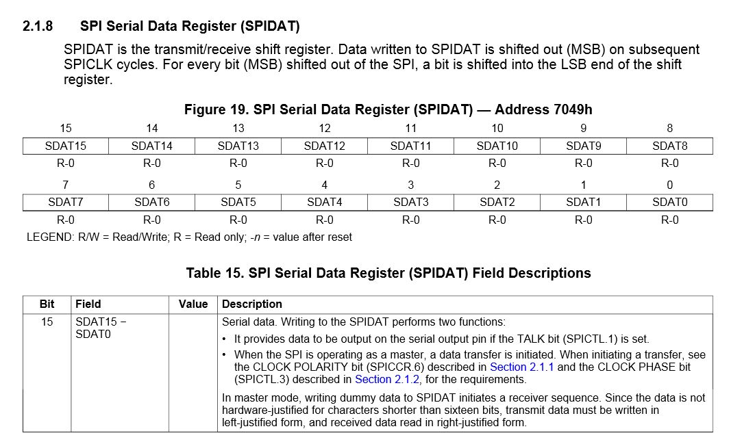

Is it possible to reset the SPIDAT register?
Hi everyone,
I have a program running on an F28035, acting as an SPI slave (the word length is 16 bits).
I would like to erase the SPIDAT register every time the chipselect signal goes high. I thought it could be done automatically but it doesn't seem to be the case.
I would like to manually "erase" the SPIDAT at some point, i.e to discard any incomplete word received. How should I proceed?

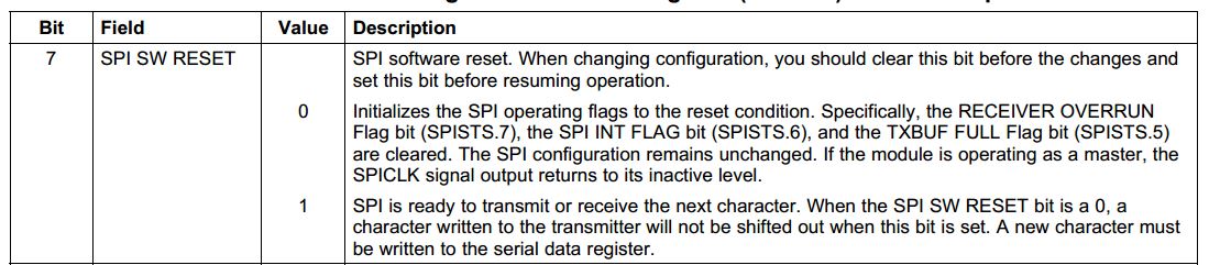

  • Could it work using the SPICCR[SPISWRESET] bit?
  • What about switching off the SPI clock by clearing the PCLKCR0[SPIAENCLX] bit?
  • What is the effect of writing a new value to SPIDAT when in slave mode?

  • Hi Pierre,
    I guess this can shed some light here:
    In short, what I mean to say is try fiddling with the SPIDAT register.
    So, only the flags would be reset but the data would be unchanged as mentioned!
    The most important thing one should remember while editing the SPIDAT value is to set/clear the flags (whichever applicable) such that when a Tx/Rx interrupt occurs the SPIDAT is updatable.
