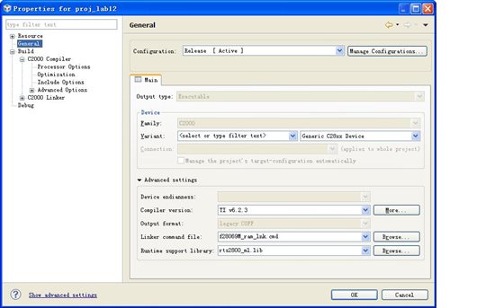

HVKIT + Estun_EMJ_04APB22, run MotorWare Lab12 has a problem
Other Parts Discussed in Thread: MOTORWARE, TMDSHVMTRINSPIN, DRV8301, CONTROLSUITE
Hardware: HVKIT + Estun_EMJ_04APB22
Software: motorware_1_01_00_11 's    lab12,  CCS 5.5, Compiler Ver.6.3.2
Phenomenon: motor run forward and reverse erratically
Lab2a, 3a, 5c, 5e is running OK.
Estun_EMJ_04APB22  encoder Signal back to normal
when I meet Lab12, the motor can running as well with DC 30V input, but the problem occurs in AC 220V.

others setting are default value , please help me to find the problem
Thank you!
