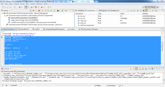

    I am using C2000 28069M with DRV8301 EVM. I have some error of calculation based on IQmath.
    Dvision, multiply, square root, give me the correct result. But sinPU function give me the wrong result.
    What could cause this?

Result is show below(right top corner)

    Did you try using IQNasin ?
    Gautam
  • Hi Gautam:
        I just add the asin function and test (font with red color). By asin(0.707), I expect 45 degree as result.
       When I run to the asin function, the error pop out as picture below.
       It says some file in tmp directory doesn't exist. And I manual look for the file at that path.
      I can't find it as well. Is there any connection with my file system? I am using ram disk as my tmp directory
      Hope it would help you to analysis my problem. And thanks.

  • The F28069M devices do NOT have the IQMath functions in ROM like the other Piccolo devices. It looks like you are using the PM_sensorless project from controlSUITE for your framework.
    Have you added the CORRECT IQMath library to your project to work with your FPU rts library?
  • I see from your other post that you figured this part out at least, and are including IQmath.
    Which version of IQmath did you include?  Looks like controlSUITE have a version called v160.  Personally I've been using v15c for sometime. Why did they rev from 15c to 160?  That's strange...
    Make sure you use the _fpu32 version since it looks like you are using FPU in your system
    IQmath_fpu32.lib

  • why is your project looking for asin.c ?
    I believe this is only something that would be used with the CLA.
    I feel like your project is all mixed up with different files that don't belong.
    Can you start with a fresh project?
