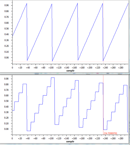

  • Here is a comparison between the electrical angle generated from the A/B/I encoder(top) and that generated from the absolute encoder (bottom).
    -Tamil
  • Tamil,
    What electrical speed was the motor running when you captured that data?
    I did notice that as I increased the speed I was unable to achieve maximum motor speed with the reduced rate of angle updates and I had trouble maintaining speed if I injected disturbances.
    This is most likely a similar problem to the one that you are seeing.  It seems like we aren't able to generate enough torque because the angle is not being updated fast enough.
    With my Anaheim BLY172 motor I can't generate good torque above 200Hz with the 1kHz angle update rate.
    I think this is the issue.
  • Hi Adam,
    When i captured the data shown in the plots in my previous post, the motor was running at 1000 RPM which is 183.33 elec. Hz. But I wasn't seeing a good response at 500 RPM either. While testing, I did not inject any disturbance, but just had a load attached. By bad response I mean the actual speed varying between SpeedRef +/- 10%.
    What I am not able to comprehend is that why would the system behave well when the A/B/I encoder feedback is used with the updates happening at 1kHz but wouldn't respond well with the feedback from absolute encoder at ~1.2khz while running at the same speed.

  • Tamil,
    Do you have the ability to run both encoders in parallel?  Could we compare the data from both encoders?
    I don't believe the issue is with the speed controller.  I think the issues is in the FOC.
    The thing we haven't been considering is the delays associated with the absolute encoder.  You mentioned there is a fixed time-delay of 250us from when it takes a reading until it beings transmitting.  After there there is a delay until the data is fully received by the microcontroller (assuming 8 bytes of data this works out to 625us).  For a total delay of 875us.  During that time the motor is still moving.  And so the angle we are going to begin establishing in our stator is now 875us old.  And we are going to hold that old angle for about 1ms.  So when we look at the worst case of this stack-up our angle is 1.875ms old.
    Maybe this encoder isn't fast enough to do sensored FOC.  Have you used this encoder with other motor control projects?
  • Hi Adam,
    The plot capture from the previous post was taken when both encoders were running parallel. I was computing angle from both encoders but feeding only the absolute encoder angle to the controller. In other cases, I would do the same while feeding only A/B/I encoder angle to the controller.
    I see that the delay could definitely be a problem as you explained and could probably be the reason why we are seeing the speed ripple. I talked to the encoder manufacturer's support team and they said that the 250us is a fixed latency, but that I can reduce the communication delay by switching to a faster version of the encoder which can communicate at speeds of up to 1Mbps on Asynchronous RS-422 or up to 4Mhz over SPI. Regardless of the communication speed, the fastest position update these encoders can give is 4kHz.
