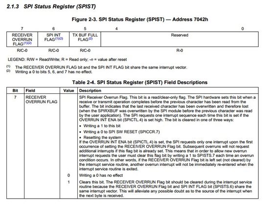

i wonder "example_280xSpi_ffdlb_int.c" code.
function void spi_fifo_init()
"SpibRegs.SPISTS.all=0X0000;" -> I wonder if any changes occur.

    I wonder why the example code written for No effect ?
    Regards...
  • I wonder why the example code written for No effect ?
    If you check the initialization, they're just trying to initialize SPISTS to default 0 values (disabling the receiver overrun flag) Also the developer wants the user to know what he's doing, even though that step is not required :)
