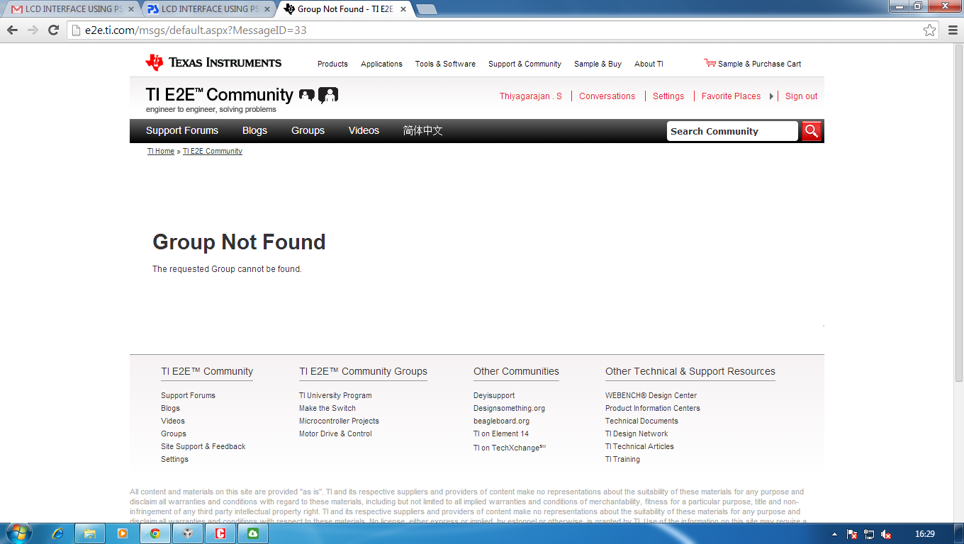

  • Gautam ,
                     Just i watched the Registers. My Compare Registers are not updating .... kindly look a screenshot image and see the attachment i attached my code too.

  • Gautam,
           I didnt get your reference code yet., when i clicked your link it getting as error "Group Not Found"
    Many Thanks,
    Thiyagarajan.S
  • Updated the link or else just copy and paste the above link.
  • Same Response , Getting Group Not Found Error.....
  • There's some issue, copy this link and paste it:
    www-s.ti.com/sc/techzip/sprc097.zip
