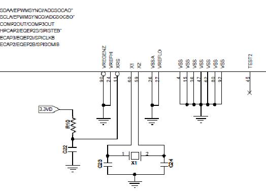

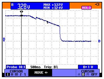

I am using TMS320F28069 piccolo controller. I observed that during multiple times power off - power on condition of 3.3V DSP supply, in some case DSP gone to hang. Here I put snap shot of 3.3V supply during power off condition.
And also some information of schematic with values of XRS pin.
R10 = 2.2k
C22 = 0.01uF
I also play with different condition of BORENZ bit = 0 and = 1 condition. But not effect in result.
Any one have face this type problem.
