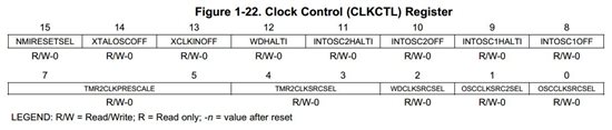

  Am newly designed  TMS320F28069 cutom board for my project with XDS100 USB V1 Emulator..
1. I didnt imported any crystal on board i planned to use internal oscillator ,
2. VREG - i disabled internal voltage regulator by pull up the VREG pin ,
3. I checked my piccolo microcontroller all, vdd and vddio pin all are properly connected to proper voltage ,
4. i pull up the TDO and GPIO37 .
 Just i simply started doing led code with the help of control suite installed program. , code was compiled without error , after debug option, it successfully connected the and loaded the .out file ........ but while executing i not got a output . ........... so i started single stepping using step into , step over and watched the Registers .. it not writing the values to the register... register is not write effect . it keep on the default values ...
Image for your reference
For what reason it happens like this ..........? kindly solve my issues please.......
Many Thanks,
Thiyagarajan.S
  • Did you execute an EALLOW instruction before trying to configure the GPIO control registers?
    asm(" EALLOW");
    - David
  • David,
           You are right , i used  the EALLOW and EDIS ; instruction start and end of writing the GPIO register . i can able to glow the led by doing single stepping on debugging mode.          Now am trying to write a delay for 1 milli second loop. i didnt import any crystal., am directly working as per settings from this file F2806x_SysCtrl.c .
    1. I would like to know which internal oscillator is setted by this file whether int osc 1 or 2 ?
    2. At what Mhz its running ?
    3. where and which document i want refer for clock setting in this file ?
    If the above all clear , then i start writing my own delay loop function for 1 milli second .,... the file  for your reference
    You can get more on this if you check your:
    DSP2806x_Examples.h and DSP2806x_SysCtrl.c files.
    And you can switch between the two internal osc. by altering this register:
    Check the same files listed above. Also in the main program we call InitSysCtrl(); function; which includes clock initializations. Use the button F3 to navigate inside these functions for easy tracking and studying.
    Refer this doc: http://www.ti.com/general/docs/lit/getliterature.tsp?baseLiteratureNumber=spruh18&fileType=pdf

  • Thiyagarajan,
    If you look at the file you attached to your post, starting at line 61 you will see this:
     // Select Internal Oscillator 1 as Clock Source (default), and turn off all unused clocks to
    // conserve power.
    IntOsc1Sel();
    // Initialize the PLL control: PLLCR and CLKINDIV
    // DSP28_PLLCR and DSP28_CLKINDIV are defined in F2806x_Examples.h
    InitPll(DSP28_PLLCR,DSP28_DIVSEL);
    So, the code is using internal oscillator 1.  Also, if you look in the file F2806x_Examples.h which is used your source file, you will find this:
    #define DSP28_PLLCR   16    // Uncomment for 80 MHz devices [80 MHz = (10MHz * 16)/2]
    So, the device is being configured for 80 MHz operation.  Now, this is because you are using v1.30 of the header files.  These are old.  You should update to v1.36 in ControlSuite, which are the latest versions.  In v1.36, you find this instead:
    #define DSP28_PLLCR   18  // Uncomment for 90 MHz devices [90 MHz = (10MHz * 18)/2]
    which means 90 MHz operation.  This is because F2806x was originally designed for 80 MHz, but later qualified at 90 MHz.  So, the header files were updated.
    The clocks and PLL are documented in the F2806x Technical Reference Manual, literature # spruh18d.
    If you download appnote SPRA958 from here:
    http://www.ti.com/mcu/docs/litabsmultiplefilelist.tsp?sectionId=96&tabId=1502&literatureNumber=spra958l&docCategoryId=1&familyId=1414
    there is already a DelayUs() function that gives microsecond delays at 90 MHz.  You can expand this to millisecond by using a simple macro:
    #define DelayMs(a)                        \
        Uint16 i;                             \
        for(i=0; i<a; i++) DelayUs(1000);     \
    The above macro should work for any other microsecond delay function you have as well.
    David
