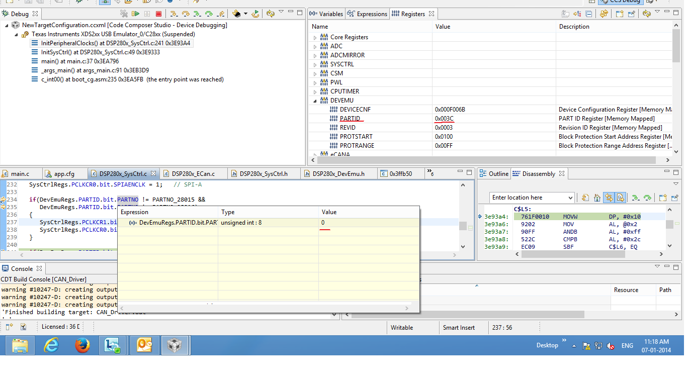

I have configured and selected device for TMS320F2808. But while debugging I am not able to get
DevEmuRegs.PARTID.bit.PARTNO=PARTNO_2808
where #define PARTNO_2808 0x3C
I am using TI TISRC folder and its source files as DSP280x_sysCtrl.c file. This register gives me value as 0 or 255 but not 0x3c.
Please help.

  • Hello David
    Thanks for yor reply.
    But I am not assigning value anywhere in code. I am just comparing 0x3C value with PARTID bit.
    I could see 0x3c val in register settings but if i hover the mouse on code bit value i get 0. so my condition get false.
    Please check snap shot.
    Please reply
    Newbee
  • NewBee,
    Since the CCS register window is showing the correct value, there is nothing wrong with the hardware.  Sounds like you don't have the peripheral header structures linked correctly.  If you add &DevEmuRegs to the watch window, do you get the correct address?  Also, what's with all the warnings showing in the Console window?  It's always a bad idea to ignor compiler warnings.  Maybe you forgot to include the linker .cmd file for the peripheral header files (DSP280x_Headers_nonBIOS.cmd) in your project?
    David

  • thanks for your replies.
    But I am using ITSRC file where comparison is only done.
    Well... I have resolved that problem as DSP280x_Headers_BIOS.cmd file was missing in project folder.
