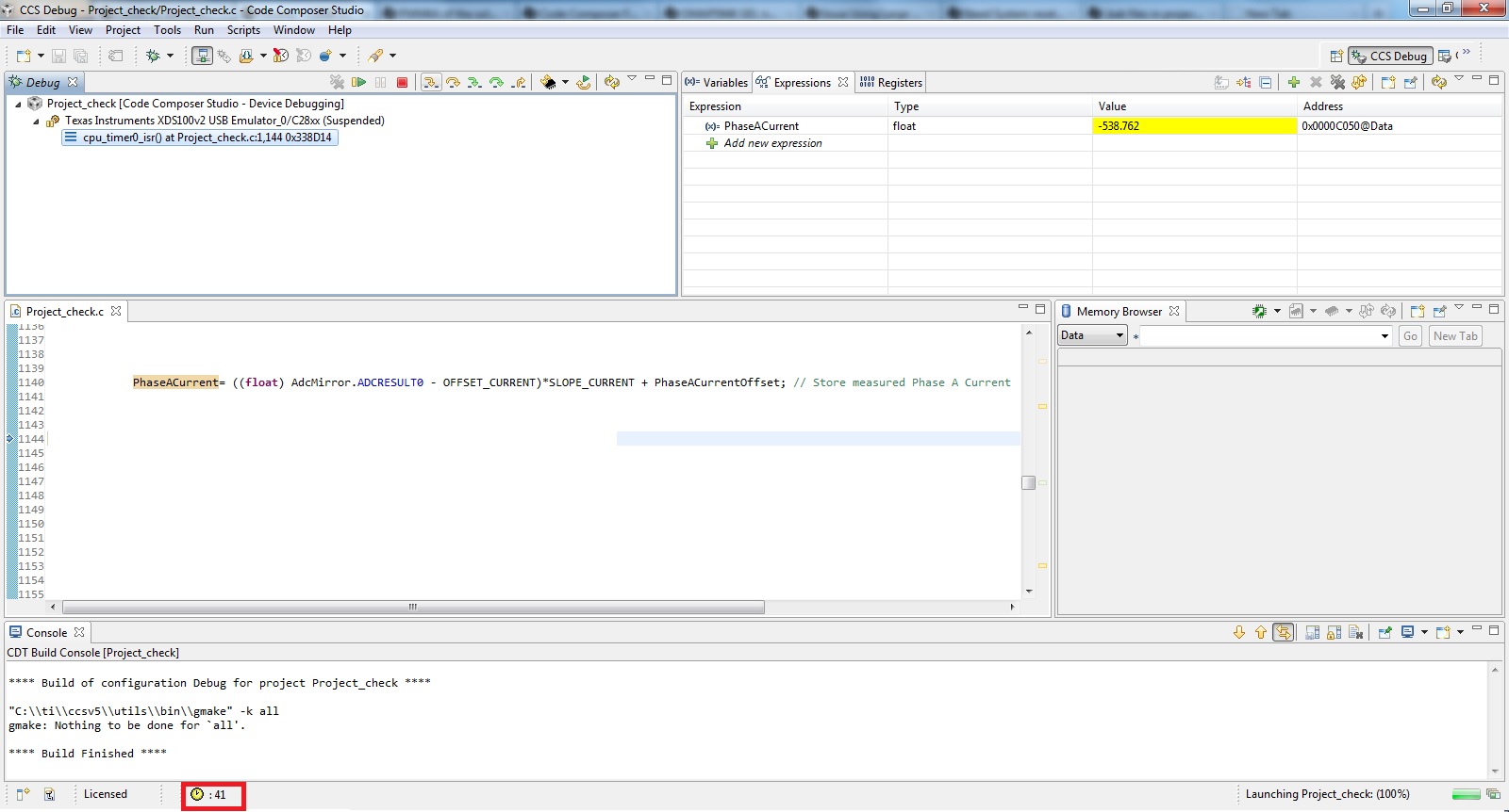

    I somewhat feel what you've observed is faulty. F28335 is one the best in class mcu and so I, myself checked the same on my F28335 control card. Here are my observations:
    Conditions and the constant values remain the same as described above:
    Also, FPU is faster than IQMath. IQMath is specially meant for fixed point DSPs. Please follow this procedure to eliminate the clock tick error:
    While in debug mode, Go to the equation line -> Right click at the start of the line-> Click on Run to line -> Enable Clock (Please check if its initial value is 0) -> Click on "Step into"
