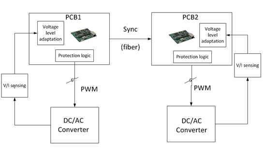

I attach a schema of my system with the aim to make my exposition clearer:
Each concerto card is connected to a PCB by using a DIMM100 connector. The PCB is quite simple. it contains an analog part that adapts the voltage levels driven by the current and voltage sensors to the range [3.3V-0V] and a digital part that protects the converter from undesired PWM outputs that could happen during the CCS debugging process (mainly during the loading process).

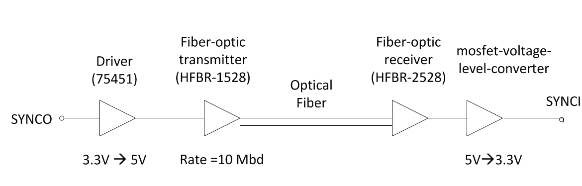

    I tried several options. First, I directly connected the SYNCO input (GPIO33) and the SYNCI (GPIO32) through the two PCBs. Each PCB provides SYNCI/SYNCO connectors which are connected to the respective pins of the DIMM100 connector associated to GPIO32/33. I used a PVC insulated solid wire to connect both GPIOs. It didn't work. Then, I tried to connect both GPIOs through their MUX connectors. It didn't work either. Afterwards, I replaced the solid wire with a coaxial cable ( the shield was connected to GND) and carried out the two mentioned alternatives of connection. It failed again. Finally, I gave optic fiber a try and it worked (but only outside the cabinet). I attach a sketch of the connection scheme:
    In the master side, I adapt the voltage level of the synco pulse to the optic transmitter. In the slave side, I convert the voltage level from 5V to 3.3V by using a MOSFETr (2N7000) which drives its output to the SYNCI GPIO.

    I've built the set up Juan was describing, and I can see the SYNCO pulse at the receiver side in the drain of  2N7000. It is inverted, and this is good because I wanna use the SYNC together with an enable signal and if the optical link is disconnected, in the drain I will get a '0' logic which is exactly what I need. The question is how should I invert the SYNCO at the transmission side? I've tried inverting it with LM339, but I guess the pulse is too short and that's why it doesn't work (it works for other signals). I've tried using 2N7000 as at the receiver side, but still it's not working. I'm doing something wrong, but I can't see what.
    Do you have a tip for me?
    Monica
  • Hi Monica, I used this schema (http://www.hobbytronics.co.uk/mosfet-voltage-level-converter) to connect the optical output to SYNCI input of the Control Card. This configuration doesn't invert the signal so I wonder what kind of configuration you use. Could you attach a scheme of it?
    Regards, Juan.
  • Hi Juan,
    I've used this schematic:
     VDD is the 3.3V.
    I've tested the slave board and it works also with the inverted SYNCI, but I will change to the schematic you've showed me.
    When you have some time, could you shortly explain me what's the benefit of using 2N7000? I was thinking to use a simple voltage divider. Would that work? Is it a good practise?
    Thanks a lot,
    Monica
