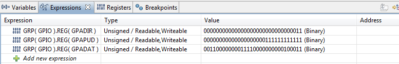

My problem right now is that my code - toggle LEDs on button press - works fine when I step through it (F5) but if I actually play it  (F8 button) it seems to start running code  from flash (if that's possible)????EDIT: After it runs though once or possible a few times, not sure what it's clocked at. I am not certain about this but it looks like the temp/adc example that came loaded on it (no serial comms though)- LEDs 3 and 4 remain on and if I try to do anything in the debugger - eg pause, it crashes and gives me this error: No source available for "0x3f63b6" .... The code should just sit in an infinite loop, but it is getting out somehow?

    *This isn't an example, although I have successfully run some control suite examples as well a 'blinker' example that was linked somewhere in the c2000 wiki - can't find it anymore -it's not a hardware issue at least. It's entirely possible I have some of the setup incorrect - couldn't find any succinct project setup document so I traced through examples to find the headers/etc required. Should have spent some time finding the documentation but what I have is the driverlib.lib, F2802x_Headers_nonBIOS.cmd and added the headers included in controlSUITE to the includes property so that DSP28x_Project.h could build.
    *Placing a break point at the end of the main loop, I can see that the registers are manipulated exactly as I wanted them.
    if I then let it go past the breakpoint (by turning it off, I can run it through to the breakpoint forever without issue) - where it should just sit in the loop, the registers spontaneously reset themselves to the following. (bit 12 of PUD went low-hard to see)
    This is where I thought it might be somehow running from flash but looking at the registers in real time, it seems that it's doing a whole lot of nothing at all, except for initially manipulating the registers once and then they are stable. -Need to figure out why it sets the registers to something without being told to. -Seems that the LEDS aren't lighting up as a result of IO hi-Z because the bits in GPADIR are set low for them?
    *Re GPIO12, I had a look at what was happening with a dmm and found that it wasn't latching per se but with out bit 12 of GPAPUD set high, the 'low' side of the switch floats at about 1.3V which I suppose is well above what the MCU thinks is low? - With  GpioCtrlRegs.GPAPUD.bit.GPIO12 =1 it goes to ground... Guess this is a consequence of the IOs being set up as high impedance. - Don't think this actually an issue, just something I hadn't come across before.

    -Forgot to handle the watchdog, SysCtrlRegs.WDCR= 0x0068; solves the problem. Actually had a bit of trouble finding the correct register value to disable (and later clear) the watchdog. Does TI have a document (F28027F) showing the bit makeup of each register (I assume they must but I can't find it in the datasheet or other suggested reading) - as in a row the width of the register with each bit named and then a table below with an explanation?
