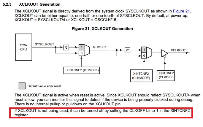

Hello.
i want disable 28335 xclkout.
i think just clloff bit set, but xclkout don't disable.
how to disable xclkout?
please let me know...
thank you.
// XTIMCLK = SYSCLKOUT/2
XintfRegs.XINTCNF2.bit.XTIMCLK = 1;
// XCLKOUT = XTIMCLK/2
XintfRegs.XINTCNF2.bit.CLKMODE = 1;
// Enable XCLKOUT
XintfRegs.XINTCNF2.bit.CLKOFF = 1;
    Here's the info you seek, I don't know why xclkout is not being disabled. How're you checking?
    Gautam
  • thanks gautam.
    But , I have already tried.
    Init Peripheral Clocks() to set XintfRegs.XINTCNF2.bit.CLKOFF was.
    (XintfRegs.XINTCNF2.bit.CLKOFF = 1;   )
    But, Ineffective.
    I'm just curious.
    regards,
  • I know, you've already tried... Above I've asked you a question wherein how do you know that Xclk is still ON?
    Also check this link: http://e2e.ti.com/support/microcontrollers/c2000/f/171/t/87276.aspx
    Gautam
  • CLKOUT pin to an oscilloscope confirmed.
    CLKOUT pin is only connected to the T.P.
    I'll link to read.
    But I do not know English very well.
    So, it takes time to understand.
    Thank you for your kindness. ^^;

  • Encountered with a similar problem on tms320c28346. You can not change the contents XINTCNF2 until external interface (XINTF) clock disabled.
    To disable xclkout do the following:
    SysCtrlRegs.PCLKCR3.bit.XINTFENCLK = 1;
    SysCtrlRegs.PCLKCR3.bit.XINTFENCLK = 0;
  • Gautam, your code will not work. XINTFENCLK = 0 by default after reset and XINTCNF2 not modified.
