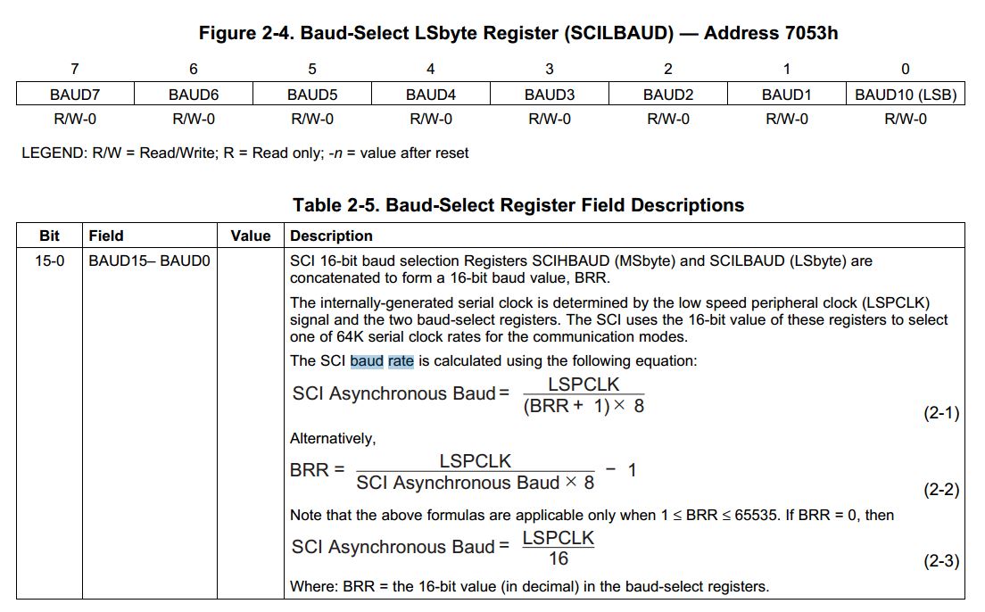

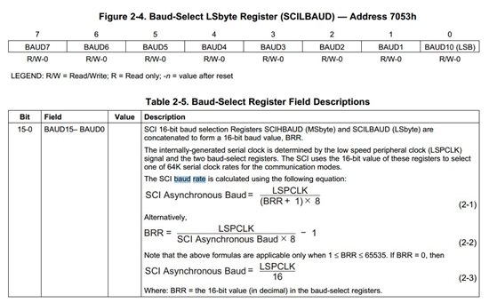

    Here's extract in F28335_SCI documentation:
    Else, you can substitute the values in this formula and calculate the maximum achievable baud rate:
    Gautam

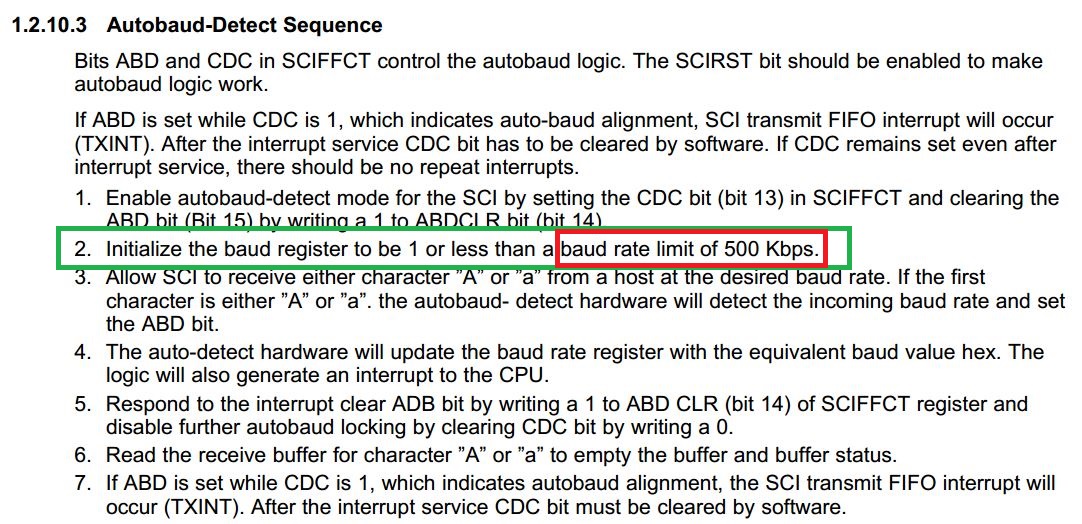

  • The limit of 500kbps aplies only in autobaud sequence. The SCI baudrate limit is LSPCLK/16. In our product (with F28335 chip) we use 921.6kbps with no problem (without any cables - internal communication only).
    Regards, Andy

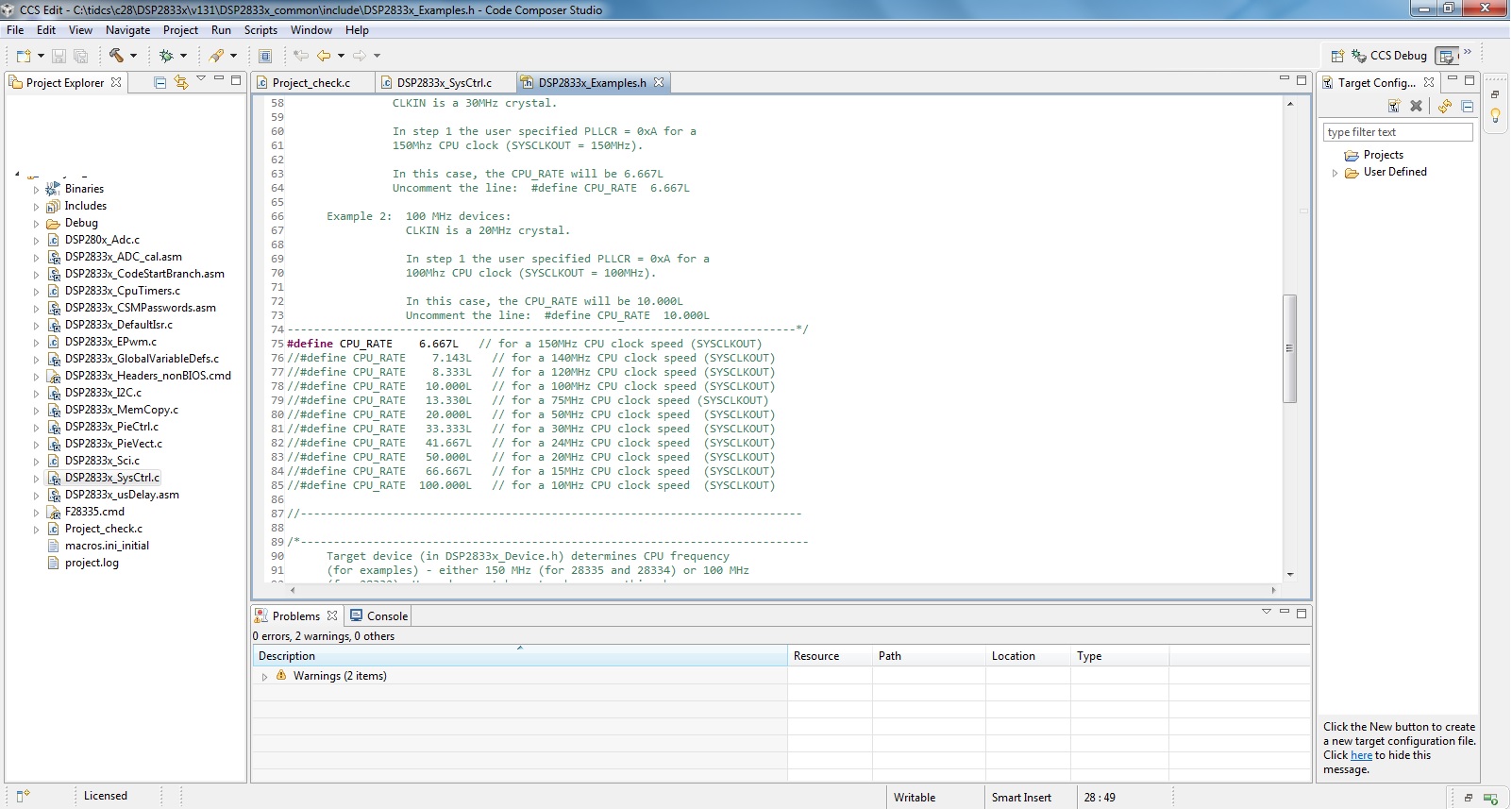

  • I did this, and got a baud rate of 294kbaud, which is plenty for my application. This means that the LSPCLK is 4.41MHz. I tried looking for this in the datasheet of the TMS320, but could not find much information. Can anyone suggest where in the project I should look to find how the central 150 MHz clock gets divided down to this value?
    Thanks for your advice, Gautam.
    Tim
  • Can anyone suggest where in the project I should look to find how the central 150 MHz clock gets divided down to this value?
    Here's where you can find the actual 150MHz getting divided, refer these 2 files in the project:
    i.) DSP2833x_SysCtrl.c
    ii.) DSP2833x_Examples.h
    Here's a screenshot too:
    Gautam
