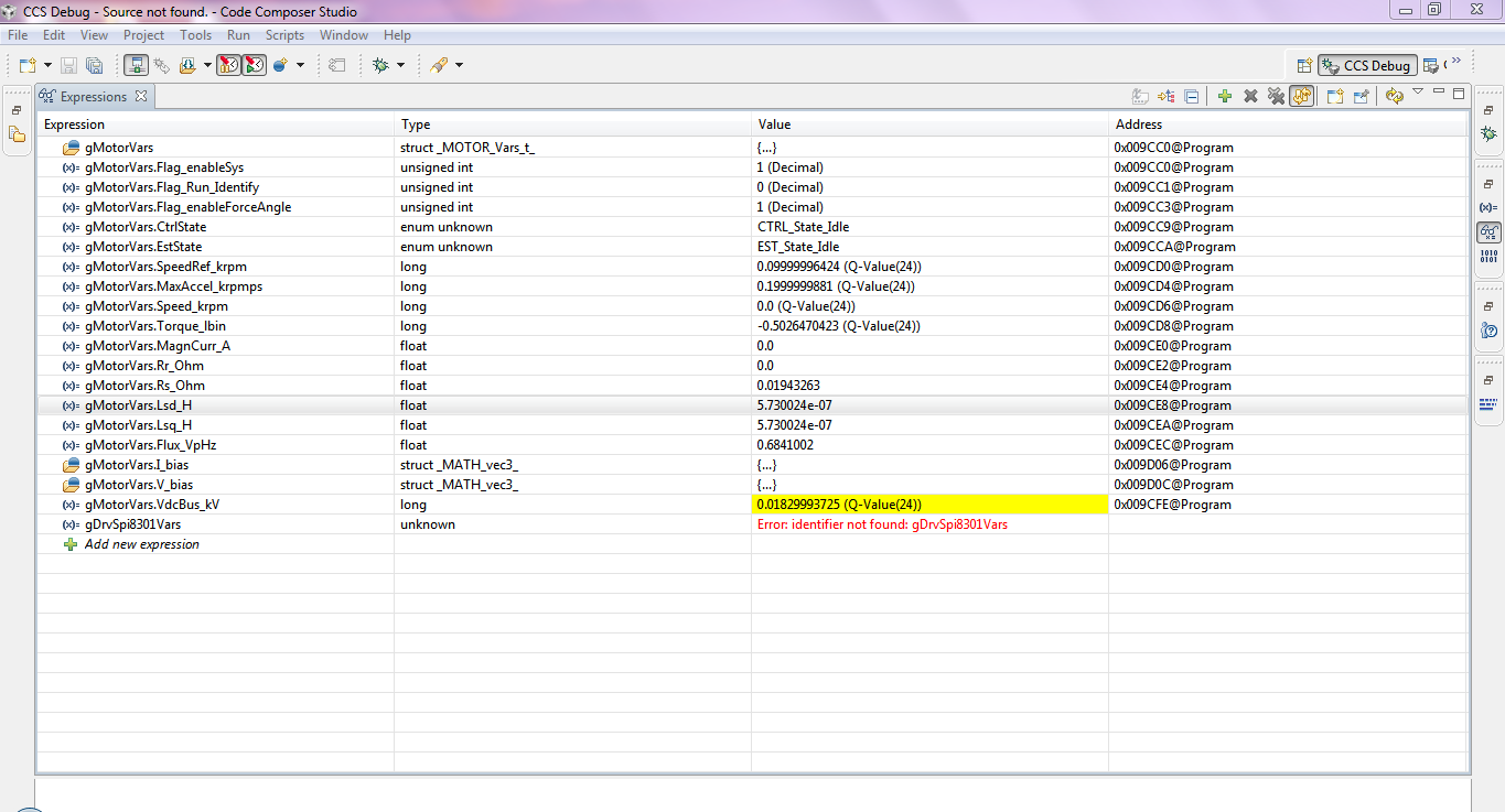

    I am using only 3 pins current sensing(one for each phase, unlike the 2 pins used in the DRV8301-69-kit for each phase ). I am not taking the I-total f/b
    However i am not using the DRV8301 as the mosfet driver. I ran the projectlab02 without making any changes in the user.h with the following result-
    As I am not using DRV8301 the SPI error is evident. Also the motor did not run even after calibration. There was no change  even after changing the value of gMotorVars.SpeedRef_krpm.

  • you have to update the drv files if you have changed the signal to pin mapping.
    but you are getting reasonable Rs and Flux values, so I kind of think you have yoru ADC channels mapped in on.
    Can you expand the Bias structures to show their value?
    Is your Rs and Flux reasonable for your motor?
    The Ls is very low. If this is really a low Ls motor (typically high speed and higher current) you need to run proj_lab2c and take special note of the IQ_VOLTAGE scaling and USER_MOTOR settings to ID your flux and Ls correctly.
