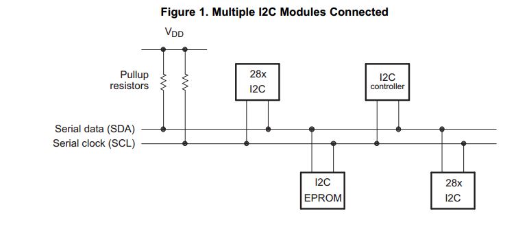

Hi ,
We are trying to configure F28335 as an master and Slave using I2C bus on two eval boards. below is the way we are trying to configure master and slave,
// Master_init Routine
// Initialize I2C
I2caRegs.I2CSAR = 0x0050; // Slave address - EEPROM control code
I2caRegs.I2CSAR = 0x007E; //slave
I2caRegs.I2COAR = 0x007F; // own address

can yu tell me what is the setting that i m missing out, so as to have a communication on my slave..?
