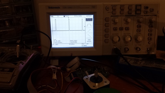

Hi everyone,
I've got a 50Hz PWM signal on the F28027 LaunchPad without too many problems... few things that don't make sense though that I would like to figure out before moving on.
*SysCtrlRegs.CLKCTL.all = 0x6400; //Use internal Oscillator/ configure some stuff
*SysCtrlRegs.XCLK.all = 0x0040; //60/4 = 15MHZ
The above does not seem to prescale the clock? at least it has no impact on ePWM3 (below).
*EPwm3Regs.TBCTL.bit.CLKDIV = 0x2;
This does work but when it should be clock/4 scaler, it doesn't work like that. (The clock is not doing what (I think) it's told)
*EPwm3Regs.TBPRD = 25000;
*EPwm3Regs.CMPB = 1500*throttle+1000; //Where throttle is float from 0 to1.
This gives a very clean 50Hz PWM with a high time of between 1 and 2ms, exactly as I wanted - and it controls servos and ESCs as intended..
What doesn't make sense is my math to fill the registers. - 60/4 = 15...15/4=3.75MHz effectively for ePWM3.
so (1/50)/(1/3.75M) = 75000. But if I put this is TBPRD I get ~150Hz, same is true for CMPB.
Also, CMPA won't behave for me (hence the use of CMPB) - even in the watcher it won't accept just any values (as B does), for instance, if I put 500 (dec) in the register it resets to 256 and setting 100 goes to >9000!!!
-Back tracking from the 25000 (in TBPRD) that works to produce 50Hz I get a clock of 1.25M, and after scaling back, 10MHz, which makes no sense since there is no scaler to get from 60M to 10M? & seemingly no combinations to arrive here, which means my math is wrong, or the clock is not running at 60M?
EDIT: just realised that I don't need to explain scaling from 60 to 10M, - seems like the MCU is clocked at 10MHz if thats possible?
Thanks for any help & I hope this makes sense, fairly late in AU.

  • Patrick,
    Without delving deep into the code I do see a few issues which correspond to your questions:
    1) SysCtrlRegs.XCLK does not impact SYSCLK/SYSCLKOUT.  Instead it impacts XCLKOUT SYSCLKOUT which is a signal that, if brought through the GPIO mux, can be probed to help verify the speed of SYSCLK.  To divide down SYSCLK itself you have to use some combination of PLLCR.bit.DIV and PLLSTS.bit.DIVSEL
    2) SysCtrlRegs.PLLCR.bit.DIV can only be set to a max of 7.  Setting it any higher will result on it ignoring the bits that won't fit.  These means that currently PLLCR.bit.DIV is being set to 2 which is likely the major thing messing up your calculations.
    3) What are you putting into the watch window for CMPA?  EPwm3Regs.CMPA.half.CMPA?  Or EPwm3Regs.CMPA?
    I'm hoping the above gets you closer at least.
    [Edited 24Jan2014]
    Thank you,
    Brett
  • Thanks Brett,
    I had another look through the datasheet after reading your post but still cant figure out the clock.
    TBCTL: These bits determine part of the time-base clock prescale value.
    TBCLK = SYSCLKOUT / (HSPCLKDIV × CLKDIV)
    So presumably SYSCLKOUT does impact the ePWM peripheral clock? Still, playing around with this and various clock configurations I can't get the clock where I want it.
    My configuration:
    This should give SYSCLKOUT  = 60M/4 =15MHz
    EPwm3Regs.TBCTL.bit.CLKDIV = 0x4;
    /16
    EPwm3Regs.TBCTL.all = 0xC033;
    Sets  HSPCLKDIV to /1
    TBCLK = 15M/ (1× 16) = 0.9375MHz
    This is not what it is actually running at though.
    Then I have the 'actual' clock set function SysCtrlRegs.PLLCR.bit.DIV = 0x2;  and I have DIVSEL set = 0, so that the clock is scaled by half again.  Not sure what to do with this, but I have tried a few things and nothing is giving me the clock speed I expect - from the ePWM output I'm seeing.
    *Re CMPA, I suspect that I am simply watching the wrong register - I was watching GRP( ePWM3 ).REG( CMPA ) which is just what shows up in the register list. Should be watching .half for this?
  • Patrick,
    Sorry, I made a mistake in my response which may have made things more confusing (not less confusing).  My previous post hopefully makes more sense now.
    Based on your previous code (23Jan) I believe the below to be true:
    1) You are using the 10MHz internal oscillator as your clock source.
    2) The PLL settings multiply the clock source by 2 (18 isn't possible as described previously) and dividing it by 2.  This means that after the PLL you still have a 10MHz clock. So SYSCLK/SYSCLKOUT is 10MHz.  This would mean that your processor is under normal conditions executing code at 10MHz.
    3) In the PWM module you have HSPCLKDIV and CLKDIV divide SYSCLK by 4.  So the PWM clock for ePWM3 is now 2.5MHz.
    4) With a TBPRD of 25000 and the PWM module in up-count mode I would expect the PWM period to be 100Hz. (in up-down count mode I'd expect 50Hz)
    Obviously, you were mentioning that you were seeing 50Hz so I'm off by a factor of 2 somewhere (or the code you posted wasn't the code that had a 50Hz PWM).  Nonetheless, this should get you closer to comprehending what is going on.
    For CMPA, yes, view CMPA.half.CMPA.
    Thank you,
    Brett
  • Thanks Brett,
    Very late so ill make this brief -
    Copied & pasted the code I posted (23 Jan) into CCS, definitely getting 50Hz out. I'm fairly certain this is up-count mode (my intention as it's for an ESC)  - pic of my scope is attached to make sure.
    *How can I set the oscillator to 60M, I never meant to have it running at 10M - misstep in setting up SysCtrlRegs.CLKCTL? Could you give me the register values to start from 60M and I'll try scaling again with the info you've posted.
