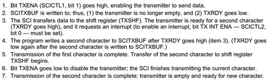

    Please check whether the above SCI code satisfies or obeys these steps:
    Rx
    Tx
    In the above code what is the initial value of SendChar.  Also, try using an if loop instead of while for SendChar conditioning.
    Gautam
