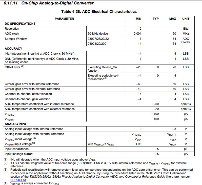

    We are seeing an ADC result of 0 for values between  0 - 0.03v, above which the ADCs appear to operate as expected, i.e. 0.07v produces the expected equivalent ADC result value as if the ADC's were working correctly.
  • Toby, are you using full range digital values? or are you using ">>x" expression while fetching AdcResults?
  • My mistake, the result values from the ADC appear to start at 0 at around > 0.03v
    so the 0.07v ADC result will be out by -0.03v. e.g. at about 0.04v we see ~4 - 7 in the ADC result register.
    I was using the Digital Power Lib ADC single channel macro to read the values from the ADCRESULT register, but now I am observing the register directly in the expressions window and still seeing the same issue.
  • I've noticed that this issue is not present with all the ADC's... ADCIN A0, A1 & A2 appear to function as expected, but the rest of the ADC's follow the issue as described above :\
  • Yup, there seems to be an offset as you've mentioned earlier. Do you feel ADCREFTRIM register is playing a part in this? Did you try commenting the same and just calling ADC calibration?

    I ran the example project again, which calls the InitSysCtrl() function from the file DSP2802x_SysCtrl.c. Within this file I commented out the call to DeviceCal(), replacing it with a call to AdcOffsetSelfCal() from the file DSP2802x_Adc.c, which sets OFFTRIM only, not REFTRIM. This didnt seem to result in any change.
    I proceeded by commenting out the the ADC cal altogether, which only resulted in the observed offset worsening to ~0.062v.

    FYI, here's ADC accuracy data:
    Gautam

    I realised that because the InitSys() (and DeviceCal()) is called before InitAdc(), in both the example and my project, the ADC is being power cycled and reset after it is calibrated.
    Thus, after your suggestion on the order toe call AdcOffsetSelfCall(), the issue is, somewhat, resolved.
    The previous ADC offset value being provided after DeviceCal() was 8. Using the AdcOffsetSelfCal this becomes 47.
    This means that the ADC result registers to record values other than zero within the 0v-0.03v range. However, to be precise the offset is now a little high! With some experimentation it seems like an offset value ~20 would be better suited. Also of note is that the offset disparity between the ADC results mentioned previously, still remains with these channels (A0, A1, A2) now reading slightly higher than the rest....
    This will however suffice for our purposes at this time.
