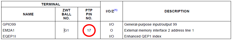

According to the datasheet, TMX320F28377D PTP package has the GPIO99 port.
Does it exist?
Isn't there a mistake in the datasheet?
    Does it exist?
    Yes, it does exist.
    Gautam
    Yes, I already know that.
    However, GPIO99 is not working.
    So, I asked the question here.
    I set the GPIO99 to the general-purpose output and change data register.
    But, the port output is not changed.
    I wonder that functionality of GPIO99 is vaild in TMX320F28377D PTP package.
    GPIO99 is initialized in different way, unlike other pins?

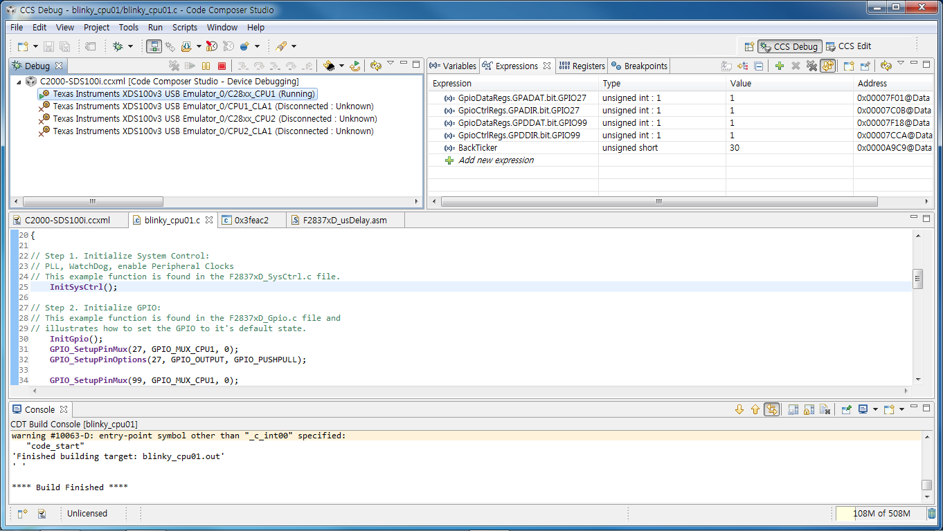

    I use TI's basic example. (See attatched source file and capture image)
    GPIO27 is work well(pin's logic state changed). But, GPIO99 is not work.

    Try using this:
     EALLOW;
           GpioCtrlRegs.GPDMUX1.bit.GPIO99 = 0;
           GpioCtrlRegs.GPDDIR.bit.GPIO99 = 1;   // GPIO99 = output
     EDIS;
    		GpioDataRegs.GPDSET.bit.GPIO99 = 1;		//Set GPIO99
    Gautam
