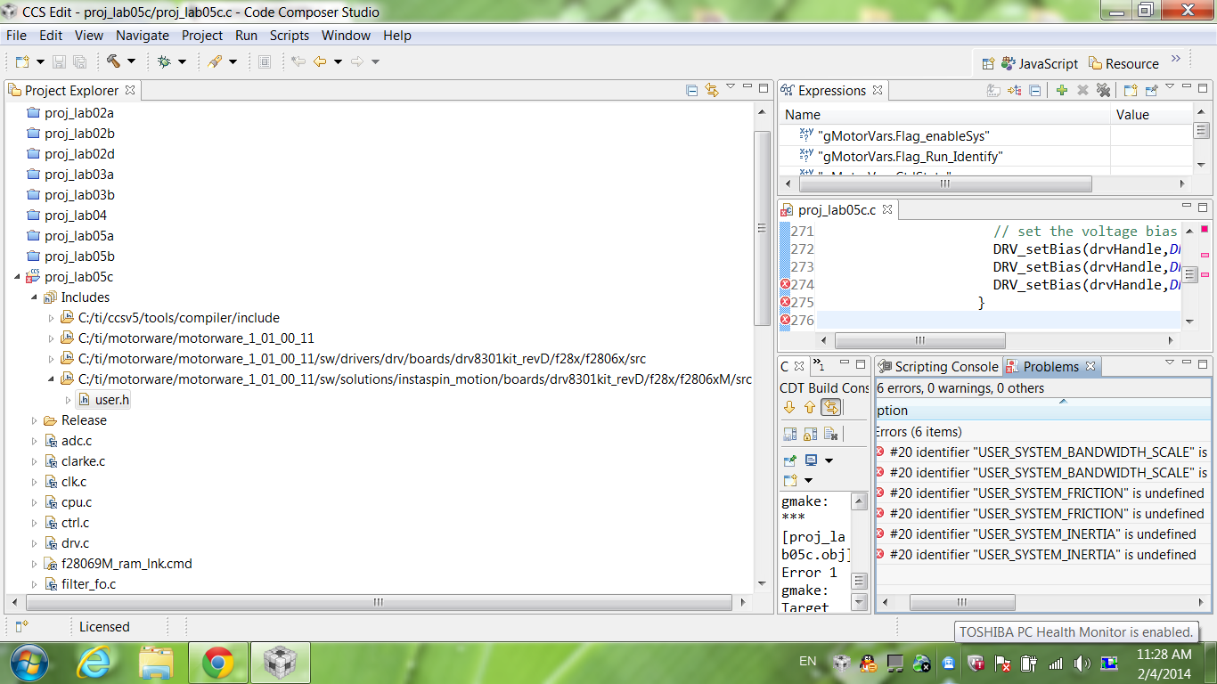

Working on lab5c and the id went through very well but when I go back to the use.h, cannot find the inertia and friction (USER_SYSTEM_INERTIA and USER_SYSTEM_FRICTION) which suppose to be modified by identified values.
I copied the user.h from _FOC folder to _MOTION folder previously (following the instruction). Is this the reason??
  • I closed everything and do lab5c over...
    Even worse this time that the "Build" cannot even go through... Some errors reported as attached. Obviously, user.h in _FOC does not have inertia and friction variables... Also, since I did copy, I have lost original user.h file in _MOTION folder. What to do then?
  • yes, it is because you copied over the entire user.h file from FOC to MOTION solution.
    Attached is the default drv8301 MOTION user.h that ships with MotorWare _11. Place it here:
    C:\ti\motorware\motorware_1_01_00_11\sw\solutions\instaspin_motion\boards\drv8301kit_revD\f28x\f2806xM\src\
    then update the user.h and any other sections you modified.  You can use a free tool like Beyond Compare to do this quickly if you have multiple lines changed.

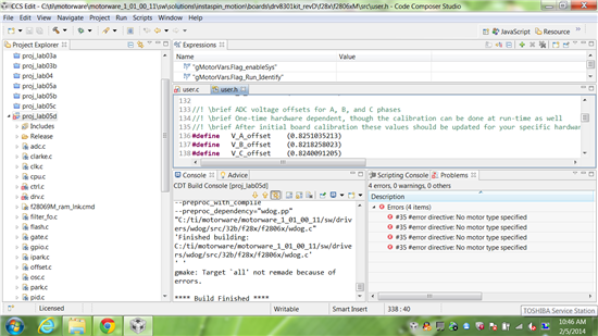

    I updated user.h in _MOTION and some errors reported when building8865.user.h0257.user.h the project. I'm attaching my updated user.h file here and according to the user.h from _FOC, I modified user.h in _MOTION at:
    1. row 129 - 138;
    2. row 338; row 355;
    3. row 363 - 379;
    The error screenshot is shown below:
    Anything wrong here??
  • you are missing having your motor selected
    #define My_Motor                    104
    #define USER_MOTOR My_Motor
    and then make sure you have a section with
    #elif (USER_MOTOR == My_Motor)
    #define
    Note that the MOTION projects have  few more #define USER_MOTOR variables that you need to add

  • I believe I have them: 2 and 3 below:
    1. row 129 - 138;
    3. row 363 - 379;
  • you have a typo, the names don't match. I do it all the time :)
    if you can't find it, attach the user.h and I'll fix
  • Checked it over again... and couldn't find it still...
    Could you pinpoint it for me?? 4300.user.h
  • does changing
    #if (USER_MOTOR == Estun_EMJ_04APB22)
    to
    #elif (USER_MOTOR == Estun_EMJ_04APB22)
    fix it?
  • It works fine now.
    Really appreciate and also sorry for such kind of "wasting-time" mistake...
