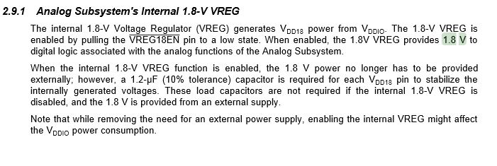

Since the Concerto has pins tied to the internal 1.8V regulator, I'm wondering if they can be used to supply power to an external chip.  I'm specifically looking at a part that draws 17mA max.
I don't see anything in the Concerto documentation that talks about drawing current from the internal regulator.
