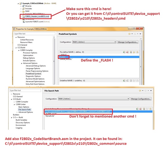

    Perhaps, you have missed something. Did you add the file CodeStartBranch.asm to your project, for example? Try to go through this AR 8231.TI_Running_from_Flash_spra958l.pdf. I hope this will help.

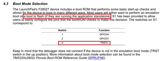

  • Hello Juan,
    FYI, F28027 Launchpad has switch for standalone/debug mode.
    SW1 BOOT position 3 has to be OFF if you want to run in standalone mode.
    5141.Launchxl-f28027f-spruhh2.pdf

  • Another things about standalone flash project, maybe you can follow these steps below after opening an example from Controlsuite.
    Good luck!
    Maria
  • Thanks to all for replies,
    Finally with Gautam and Maria suggestions I can put my own project to run standalone, I just linked "F28027.cmd" instead "28027_RAM_lnk.cmd" and it running Ok.
