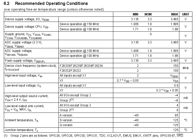

What is the maximum peak current that can be drawn from a single PWM output pin? I plan on using the ePWM outputs on a TMS320F28335. I've scoured the manual, but I can't seem to find it for the life of me. The only information I can find is that a ePWM module consisting of two output pins will typically draw 5mA. Thank you in advance!
