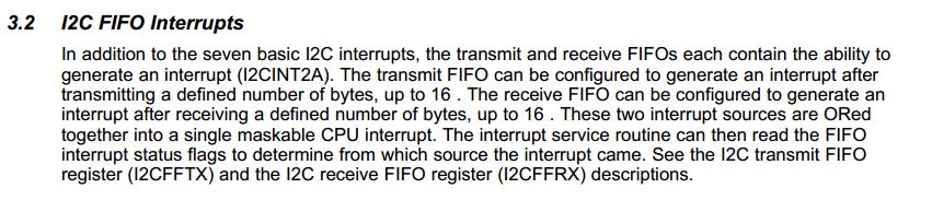

I am using the TMS320F28335 DSP and I have implemented a i2c driver using FIFO mode. Now my task is to make it work with 255 data bytes.
Is it possible to use the FIFO mode to send/receive 255 data bytes or should I change the driver from FIFO mode to regular mode with the basic i2c interrupt requests ?
Do you know an example that doesn't use the FIFO ?
Thanks in advance,
Adrian
  • Hi Adrian,

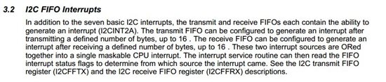

    Now my task is to make it work with 255 data bytes.Is it possible to use the FIFO mode to send/receive 255 data bytes?
    Yes, you can but not all 255 at a time. You'll to do it in lots of 16 bytes at a time.

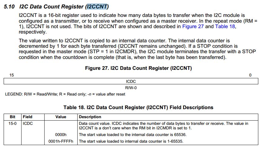

    Without FIFO, you should be able to implement the same using the help of I2CCNT register.
    Gautam
