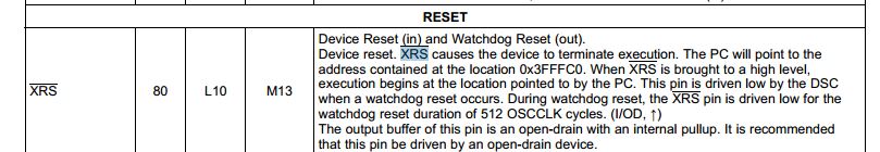

    I have a doubt regarding the effect of external reset on the code executing from ram
     what happens exactly to the code in ram after a reset on XRS pin
             ---- will it be erased
             ---- or starts executing from the entry point
( please note that i am not turning off the power supply )
