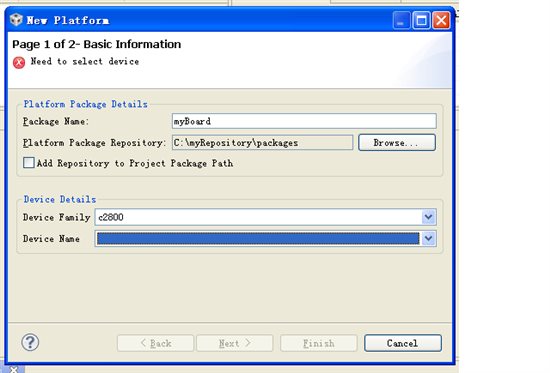

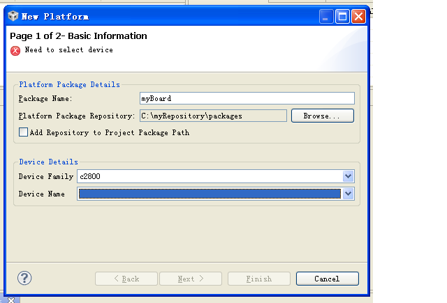

Dear Ti:
why there is no TMS320F28335?if i want creat my own RTSC packages in sysbios 6.37 what should i do?i need your help.

Refer this link:
http://processors.wiki.ti.com/index.php/Using_CCStudio_v4_to_create_a_custom_RTSC_platform
Gautam

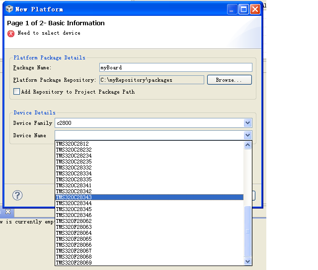

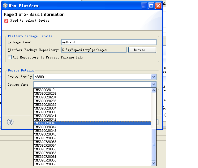

Lei, please write the part number on the "Device name". If you scroll down you should be able to find TMS320F28335. Also, which version of XDCtools do you have?
Dear Gautam:
Thanks for you help.but i still not find Tms320F28335.My version of XDCtools Is xdctools_3_25_05_94.
regards
lei

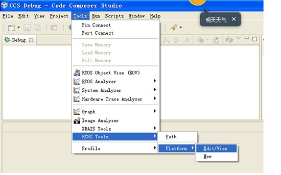

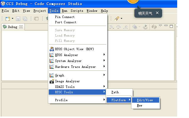

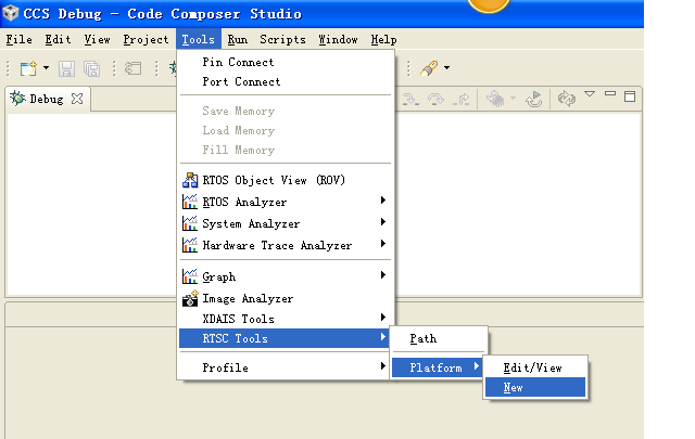

Lei, two things here:
1. A new RTSC configuration file can be found under File->New->RTSC Configuration FIle.
2. The tools menu shows up if you are in the debug perspective. Please go to the CCS Debug perspective and you will find Tools->RTSC Tools->Platform.
Let me know how it goes.
