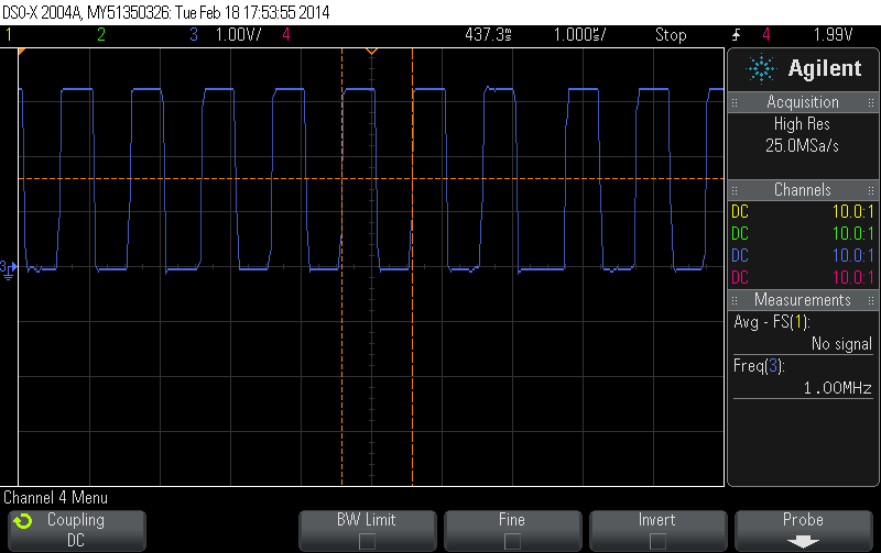

             I have found that i am not getting TCK signal to my custom board when i run a test connection from CCS. My debug process went something like this.
    1)First i connected the TI development board and recorded the activity on TDI,TDO,TRSTn,TCK signals. The following image gives the activity
    Yellow -TDI , Green -TRSTn,  Pink -TDO, Blue -TCK.. TCK doesn't look good bcoz of low sampling. actual TCK looked like square wave with frequency of  1 MHZ. Below is the picture of clock
    2) On my custom board it looked like this
    So i was not getting clk.
    When i checked that properly FTDI chip TCK was not soldered properly when i tried to do it i broke the pin of FTDI chip. I ordered a new one. Will that solve the problem?

    I cannot tell if replacing the chip will fix things or not, but you now need to do it regardless because the FTDI chip broke.  I just tried to see what Test Connection actually does to the JTAG signals on my xds100v1-based development kit.  With my setup I see similar activity to your second screenshot.  When I try to connect to the MCU, TCK does attempt to provide clocks though.
    I wouldn't recommend providing your own TCK via function generator, etc.  Instead I'd wait for the new FTDI chip.
