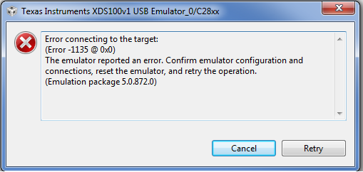

I am trying to program F28035 Piccolo Control Card using a Experimnerter's Kit USB docking station. But I keep getting the following error message while trying to debug the code:
I am using CCS version 5.3 on Windows 64bit system!

  • Here is my target configuration settings dialog box:
    and the results after running the test connection I have pasted below :

    I'm sorry for the difficulty you've been having.  Can you let me know whether your F28035 controlCARD is the:
    ISO controlCARD:
    http://www.ti.com/tool/tmdscncd28035iso
    or the
    standard F28035 controlCARD (the controlCARD plugged into the following baseboard):
    http://www.ti.com/tool/tmdshvblpfckit
    Switch settings and the method of connecting are different between the two options.
    Either way (and for this particular board+cCARD setup), you should be using xds100v1 as the connection in your target configuration.

  • I am using the standard F28035 controlCARD  but the baseboard is different from the link you sent me. The base board is a docking station with a USB Connection
  • Thanks.  I mentioned the other kit (BLPFC) because it conveniently had a picture of the correct controlCARD  :)
    Below are the key things I would recommend looking at:
    -SW1 on the controlCARD should be switched toward 'ON' (up)
    -The USB connector on the Docking Station should be connected to your computer
    -SW1 of the Docking Station should be switched on such that LD1 on the controlCARD comes on.
    -J8 on the Docking Station should NOT be jumpered.
    -As I mentioned above make sure that you are using an xds100v1 in your CCS target configuration
    If all of the above looks correct, can you let us know whether TI XDS100 Channel A and TI XDS100 Channel B show up in Window's Device Manager when the USB is plugged in?  Like the 4th picture in this thread:
    http://e2e.ti.com/support/microcontrollers/c2000/f/171/t/21086.aspx
    (if it doesn't I might recommend reprogramming your xds100v1 emulator by following the instructions in the thread I just listed)

  •  TI XDS100 Channel A and TI XDS100 Channel B show up correctly but the USB Serial Port doesnot! Is this also required to program the Card? Do I need to download the FTDI drivers?
    No, you should really only need 'TI XDS100 Channel A'.  However, just in case you may want to reprogram the FTDI FT2232D's EEPROM as in the forum post that I linked.  Let us know if this helps.
    I don't suspect the FTDI drivers at this point.  Instead I would suspect CCS settings or jumper/switch settings (as mentioned in my previous post.
    Has this controlCARD + Docking Station ever connected to CCS or is this it's first time to be used?
