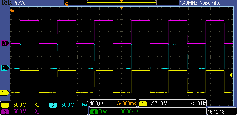

I have a custom designed inverter that is driving a 10kW, 12 pole PM motor. I'm having troubles with getting InstaSPIN Lab 2a to identify my motor - specifically, I do not see any current during RoverL and Rs identification.
The inverter has 3 motor phase sensors, 3 hall effect current sensors (ACS756) and a DC bus voltage sense:
My user.h is included here: 2746.user.h
My DC bus is at 90V, and I have a bi-direction current sensor that hits saturation at around +/-50A.
I have confirmed that my voltage and currents are connected correctly at the hardware level - I am able to inject test currents and voltages into my sensors and read PU values that I'd expect during debug in gAdcData.
I have a scope on two of the phase currents, and I expect to see a 100Hz, 5A signal during RoverL identification,  and a DC, 10A signal during Rs identification, but all I see is a flat line. I am using MotorWare _11, but I have both _11 and _09 installed.
I know the inverter's switching section works correctly, because I have previous non InstaSPIN hardware that can turn a motor.
The identified parameters (such as Rs_ohm) vary greatly. I've been able to get the motor to spin at times, just due to what I think is a random convergence of noise (very small V/I that just happened to land in a "reasonable" ratio). I can confirm that the InstaSPIN F2806 is properly toggling the gate drives for it's PWMs, and I know that the voltage and current sensors work, so I suspect it's something in the software.
I feel like I'm missing something very obvious!

  • this is a tough one. Not seeing current injected during RoverL is a big red flag.  There must be something wrong with the mapping of PWM signals in software to your inverter.
    I made some changes and added some comments to your user.h
    Fundamentally nothing wrong....especially that would cause this issue.
    Again, I would go back and look at the mapping of your PWM modules / pins to your inverter gate drive.
    2746.user.h
  • Thanks for the tips, Chris! It's good to know where to look - I'll check out the PWM assignments, and do a fresh install of all the software. I had a pretty cluttered install of MotorWare (with _9 and _11 installed) and CCS (had version 4 and 5 installed at one point).
    Where should I look to check for pin assignments?
    Thanks again for the prompt response! :)
  • Hai,
    To understand pin assignments:
    1. look at the drv.c fle first
    ex: C:\ti\motorware\motorware_1_01_00_11\sw\drivers\drv\boards\drv8301kit_revD\f28x\f2806x\src\drv.c

  • Hello Chris!
    I've made some progress my invert: I realized that I forgot to put a low pass filter on the OCP and TZ-1 pins and what was happening was as soon as the PWMs turned on (even in the idle state) the noise would intermittently trip OCP/TZ-1.  I didn't realize that InstaSPIN had latched a fault - the motor ID states in Lab2A kept going through RoverL, Rs, etc. even  though OCP has been tripped. Is there a way I can fix this issue such that if OCP trips while going through Motor ID, the controller state enters the "error" state?
    Now that I've got the PWMs working consistently at 90V DC bus, I'm still having issues with RoverL. When I go through Lab2A now, here's what happens:
    1.) Offsets gets calibrates (successful)
    2.) RoverL - no signature 100Hz current; still a flat line. I've checked and re-checked my PWM mapping (parsed though all over drv.c) and it looks correct. I based my design on the HVMTR kit, so I shouldn't even have to re-map if my schematics are correct.
    The motor voltages look like this during RoverL:
    I would expect some sort of "shifted" PWM motor voltages, but the motor voltage (relative to DC supply ground) I see during RoverL is the same as step 1, when the system was going through offset calibration.
    3.) Rs identification: motor experiences a large torque pulsation and then trips my hardware 50A overcurrent protection circuit. I don't put too much stock into this because if RoverL is not working right, I don't expect Rs identification to work correctly.
    Do you have any ideas as to why InstaSPIN would command essentially a "zero" motor voltage? Is there a way I can look at the code that determines PWM values for RoverL or is that proprietary?
    Also, I have 3 Allegro current sensors - do I have to use 2 for USER_NUM_CURRENT_SENSORS or can I use 3?
    Thanks for your great feedback, Chris!

    "1.) Offsets gets calibrates (successful)"
    How do you know it was successfult?  What are the values returned?
    "Do you have any ideas as to why InstaSPIN would command essentially a "zero" motor voltage?"
    Zero voltage vector is applied during the Offset Calibration.
    The User Guide is very clear about exactly what is occuring during Motor ID process, and you can follow through the ctrl.h / ctrl.c code.
    "Also, I have 3 Allegro current sensors - do I have to use 2 for USER_NUM_CURRENT_SENSORS or can I use 3?"
    If you have 3 you can use 3.
    Did you make any other changes or are you using a fresh install of MW _11?  Either a pin mapping or some gross timing issue has been introduced.
  • and also look in proj_lab2c at
    CTRL_recalcKpKi()
    where we poll the EST_state, which is more appropriate for what you want to do.
  • Thank you for the very quick reply, Chris!
    I'll be sure to check out Lab 2c - I haven't played with Lab 2c very much yet because it wasn't part of the HV kit labs. I'll go through the user guide and follow through in ctrl.h/ctrl.c later today and see if I find any insights.
    To answer your questions about the offset calibration - I copied code from Lab 3a to Lab 2a such that I get the bias for voltage and currents.
    My DC bus voltage was set at 90V, and I played around in my user.h such that these are my voltage and current scales:
    #define USER_IQ_FULL_SCALE_VOLTAGE_V (120)
    #define USER_ADC_FULL_SCALE_VOLTAGE_V (98.02)
    #define USER_IQ_FULL_SCALE_CURRENT_A (62)
    #define USER_ADC_FULL_SCALE_CURRENT_A (124)
    I also copied the bias calculated in Lab 2a to my user.h, and they are:
    #define I_A_offset (0.9977442622)
    #define I_B_offset (0.9945485592)
    #define I_C_offset (0.991394043)
    #define V_A_offset (0.3725035191)
    #define V_B_offset (0.409307301)
    #define V_C_offset (0.3864483237)
    These values are near my ideals: current offset ideal is 1.033 and voltage offset ideal is 0.375. I see 50% duty cycle for motor voltage during offset calibration. The results for offset calibration look correct, right?
    2.) RoverL calculation:
    Sorry for not making this clear, but this is the motor voltage I see during RoverL identification with a DC bus of 90V:
    As you can see, motor voltages are near zero for all 3 phases during RoverL identification - this is I believe a symptom of the root cause of my problems.
    Do you know what could cause the Motor ID algorithm to output 50% duty cycle for the entirety of the RoverL identification?
    I did do a fresh uninstall of all TI products on my computer and then I installed:
    CCS 5.5.00077
    ControlSuite
    InstaSPIN/Motorware version 11
    Thanks for your help again, Chris!
