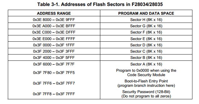

    Is there any particular reason why you're using an external EEPROM when you can emulate the same on the chip's flash sector?
    Coming to the point, if you want to send multiple data you have to check the status of the Tx shift register before writing the next byte to I2CDRR. Same setup as before, then

    Regarding your question about using EEPROM, and not chip's flash sector, is because, the data we are writing are fault condition parameters. There are many such parameters for us to store and the flash area is not enough for us to store these parameters along with the code.
    The code that was posted had the1st suggestion you had given - which is polling the XRDY bit and the problem I reported, was using this method.
    I am not sure how the FIFO mode would help me. In the non FIFO mode, do you have any suggestion?
    Thanks & Regards
    Smita
  • No problem, for the late reply.
    That's a whole lot of data! Just for your info:
    So if you emulate Sector H as an EEPROM; you can calculate how much memory you can avail.
