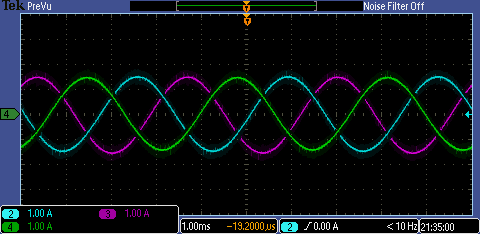

    I updated the values according to the spreadsheet, but it seems the ID code runs at the same velocity. I haven't had a chance to go through the entire code sample yet, but can I set the velocity at a lower speed, such as 60 - 100°/s? I changed the Maximum RPM motor will run cell in spreadsheet to 10 RPM, and I'm seeing the same result on the scope after plugging in the calculated numbers (see attached file). I would like to drive the motor at a much lower speed.

    I think your expectations of the InstaSPIN-FOC solution are not correct.  InstaSPIN-FOC is a sensorless solution which uses an algorithm called FAST for estimation of the rotor flux angle based only on currents and voltages.  With proper rotor flux angle knowledge a field oriented torque controller can be produced quite easily.
    FAST is dependend on the phase voltage measurements and the Bemf of the motor. The lowest speeds which it can produce acceptable angle estimations is dependendent on the measurements of these phase voltages that only occur when the rotor has some movement.  HOW slow the rotor can go depends on the Bemf the rotor produces and how accurate / resolution you can measure.   In practice for most motors good operation can be had in the 2 Hz range with well scaled voltage sensing.  Some motors have very small flux and this opeation point moves to > 10 Hz.  Some have VERY large flux and can move < 0.1 Hz
    To run, FAST needs to know for a synchronous machine the Rs, Flux, and Ls.  You can enter these if known or use the motor identification procedure.  This procedure requires the motor to be run to 10% of the rated speed for Flux and Ls identification.  So you have to use a proper power supply and inverter to allow.
    I really don't understand the requirements of your motor though. I've never heard of a motor that ONLY goes to 10 RPM. The Bemf would be absolutely enormous.
    Either way, IF your motor does have these charachteristics a sensorless motor model based approach for estimation (like FAST) is not for you.  I strongly recommend you use a mechanical rotor sensor like an encoder or resolver for rotor angle feedback to control your commutation.  InstaSPIN-MOTION may be able to help you in this regard.
