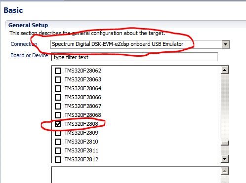

Dear David,
I've tried to configure the target configuration for f2808, using general setup in target configuration. Connection is spectrum digital xds510usb emulator, board is ezdspf2808, then save and I click on Test Connection button. the error is arise as :
------ XDS510-USB Emulator not connected/enumerated.
What's wrong?
Thanks a lot,
Ana
Ana,
So it seems the eZdsp does not quite use the XDS510USB connection. Spectrum Digital apparently slightly adjusted the emulator on eZdsp boards.
First, drivers for Spectrum Digital emulators already come with CCSv5. You don't need to install any drivers from a CD (and certainly don't use the drivers from CCSv3). Have you tried setting up a target configuration in CCSv5 using the eZdsp driver? Like this:
I'd assume the above would work. I don't have an eZdspF2808 so I cannot test.
