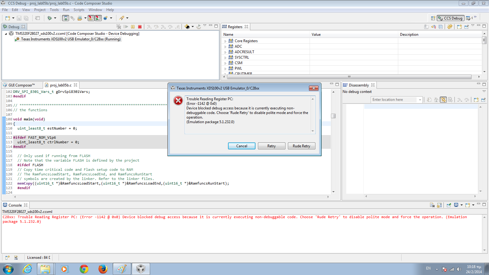

 i installed the GUI composer and I followed all the steps that were described in the "GUI Quick Start Guide InstaSPIN UNIVERSAL". When i run the InstaSPIN_F2802xF_UNIVERSAL exe everything looks to work fine, but after the launching process, the following  error  is appeared. If i select "OK" it is appeared again.
Also, when i choose the application tab i have a similar error :
Could anybody help me please? Do anybody know what i can do?

    thank you for reply. First I built the proj_lab5b in CCS5_5 and after i copied the proj_lab5b.out in webapp\InstaSPIN_F2802xF_UNIVERSAL and i renamed it in appProgram.out.
    Also , (i have the C2000 launchpad) i tried to connect through CCS and an error window opened  and the same error was appeared (see below). I press rude retry and it looks running. Why it did not running in standalone mode (outside the CCS)?

    did you solve this?  my instinct was that the switches had you booting to flash and you were able to connect but not load new code...but looking at the images it looks like you WERE able to load proj_lab5b, and then it gave you the error.  That's really strange.  It make me think there may be a HW issue and you may want to try another LaunchPad.
