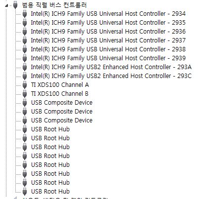

I think USB cable is working and windows driver is perfectly installed
and the LD1, LD3 on the board are turned on
I have check the Texas Instruments XDS100V1,2,3 USB Emulator.
all of usb emulator shows same error message.

  • Ok, are the drivers installed properly? Check your device manager.
    Also go through these links:
    http://processors.wiki.ti.com/index.php/XDS100#Troubleshooting_FAQ
    http://processors.wiki.ti.com/index.php/Debugging_JTAG_Connectivity_Problems
    Gautam
  • yes, Windows 7 installed the drivers automatically. and check my  device manager.
    there are not any warning.

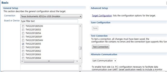

    I have questions.
    as I mentioned, I bought the piccolo F28055 Experimenter Kit.
    and PC connected with docking station by USB cable.
    so, what  should I select the Texas Instruments XDS100v1 usb emulator(TMS320F28055) or (Experimenter's kit - piccolo F28055) in TMS320F28055.ccxml file?
    but there is no Experimenter's kit - piccolo TMS320F28055 in ccxml file.
    is it possible to use Experimenter's kit, by choosing TMS320F28055 in ccxml file?
  • so, what  should I select the Texas Instruments XDS100v1 usb emulator(TMS320F28055) or (Experimenter's kit - piccolo F28055) in TMS320F28055.ccxml file?

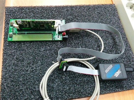

  • That's very strange! Do you've an external XDS100 emulator or any other experimenter's kit?
    Gautam
  • I have XDS 200 emulator and do not have another experimenter's kit.
    what is strange thing? could you explain it? please~~.

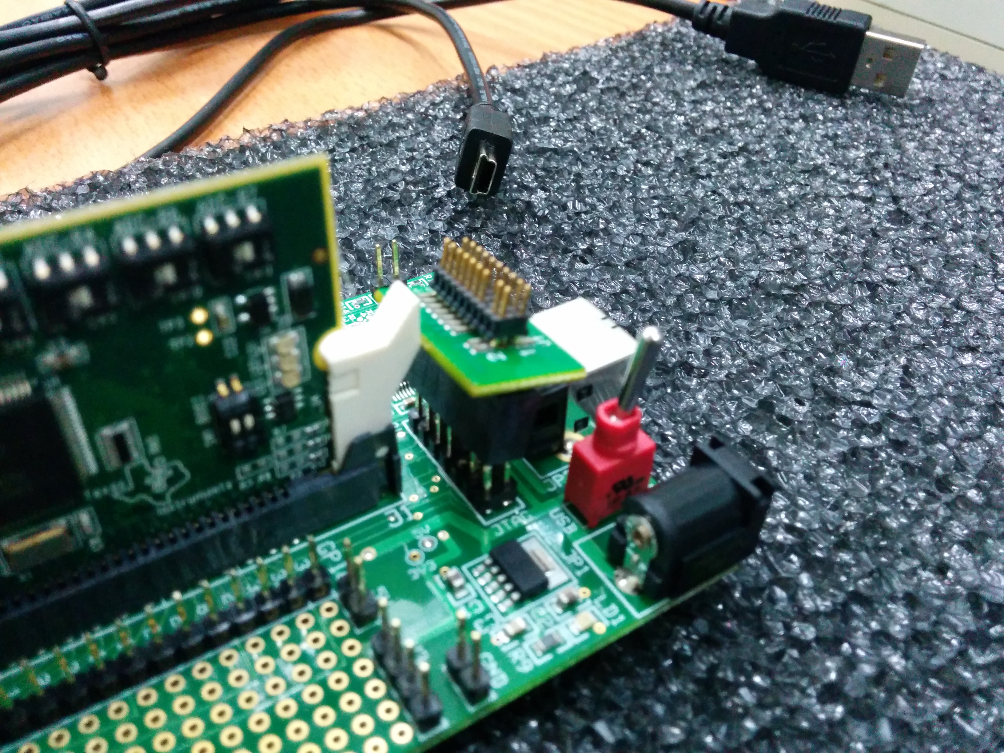

  • Try using your XDS200; insert it in J2. That should work... Let me know what you observe. Select XDS200 in target configuration window.
    Gautam
  • when switch 4 position 1 on

    Why do you have that long extender strap on the XDS200 cable?  Can't you plug the XDS200 directly in to the docking station connector?
    Also, try to power the docking station from the 5V connector, and not from the USB.
    I suspect at the end of the day, either the XDS100 chip on your ControlCard is damaged, or the F28055 on the ControlCard is damaged.  From what you showed in your previous posts, the 'Test Connection' had some partial fails (as opposed to complete failure).  That suggests a hardware problem.  You probably have to contact TI and exchange the development kit for a new one.
    - David
  • yep. I can not plug the XDS200 directly in to the docking station connector.
    because of PCB of converter. like this
    so I use extended cable.
    David, thank you for your advice and I will try to power from the 5V connector.
  • Ha,
    I see.  I forgot SD XDS200 uses small size connector, and you need to use the adaptor.  The extender cable you are using is very long.  That can make the XDS200 connection fail.  You want the extender cable to be as short as possible.
