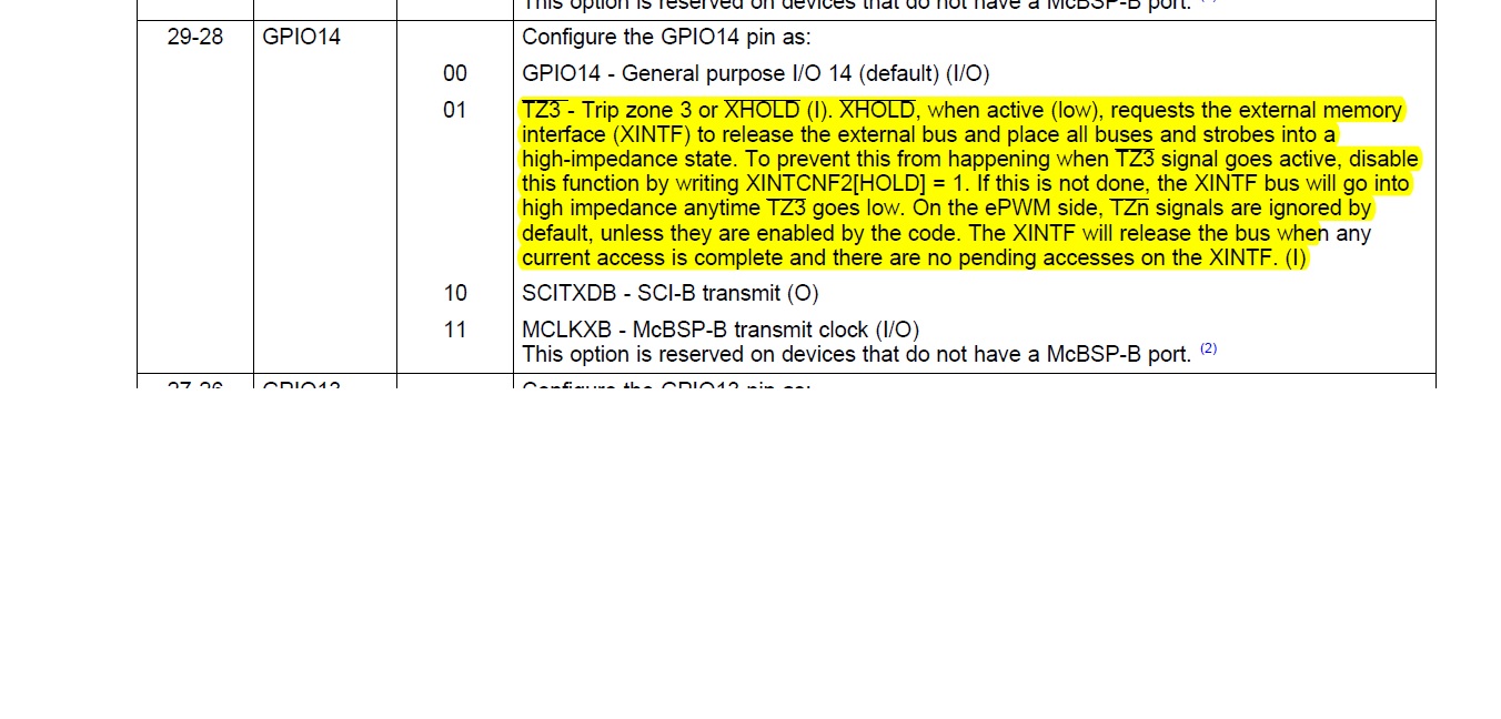

  • Hi TI-ers,
    I've been thinking: what could be the cause of the lockup of the XINTF module? I'm not sure how the CPU is routed internally, but is it the case that every (or some) module(s) have its own 1.8V VDD supply voltage? Or are they all tied together internally? Could a lockup of the XINTF core be cause by missing supply voltage, but still being able to configure the XINTF registers?
    Could the XINTF being blocked by state of external IO, even when USEREADY is set to zero (ignored) and READYMODE is zero? Or the state of some other IO pin like XWE1?
    XHOLD, XHOLDS and XHOLDAS register is not active (zero), WRBUF is set to 3 just being able to monitor any writes (which should not occur) and WLEVEL stays zero.
    I've also tried to run the XINTF module without MUX configuration, so just configured as normal GPIO. No difference.

  • Tjarco,
    Do I understand correctly that even with the errata workaround in place the XINTF module is not working correctly on the three boards?
    The HOLD and the XREADY pins can stall the XINTF.  If you are ignoring XREADY in your timing then I don't see an issue there.
    The voltage rails are connected internally to the device so if there is a current starvation issue it could impact one part of the device.
    -Lori

    Well I've got my finger on the issue. The XINTF/DMA blocks because of the state of TZ3 (GPIO14).
    If TZ3 IO is pulled low, the xRD goes also low and the DMA halts. If I release TZ3 DMA continuous and xRD strobes again. The strange thing is that TZ1 - TZ 4 are configured as TZ, but ONLY TZ3 results in halting DMA/XINTF.
    The trigger for DMA is TINT0, without sync option:

  • Tjarco,
    TZ3 on GPIO14 is muxed with the HOLD of the XINTF.  Have you turned of HOLD as described in the MUX for this pin?   I'm not sure why this wouldn't occur on the other rev of the board though.  hmm.
  • Hi Lori,
    I've set the XHOLD to TRUE to disable it and it's all fine now. You've mentioned the HOLD before. It's confusing when migrating from other C280x having TZ3 enabled and not "enabled" XHOLD and XREADY IO. Also that XHOLD is on by default (value 0).
    On the board "A" the TZ IO was unconnected and weak pulled up, so always high. On board "B" the TZ3 is low (trip state) because of the logic on the board resulting in disabled XINTF.
    Well, could the XHOLD be added to the example code for XINTF being disabled by default?
    Thanks for the support.
    Tjarco
