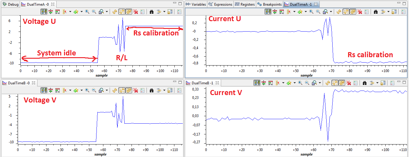

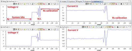

Hi guys,
When testing one custom system, I noticed following during the motor ID:
- Voltages and currents offsets calculated correctly
- Correct sensing (voltages corresponds, system voltage 20V, so after offset -10V is read)
- Rs calibration sets the correct current (1A), also checked with a multimeter
- When manually calculating Rs using the values for voltages and currents present in the system (graph tool), I get correct value for resistance (10.5 Ohm).
- gMotorVars->RsOhm shows values several magnitudes wrong (even 3E20 is possible to see)
Is some Q-value variable in the closed controller code overflowing? How can I check it?
Graph in the attachment is in Volts/Amps, rescaled using Q24 for currents, Q20 for voltages (set appropriately in the graph view as well)
  • Please attach your user.h used for this compilation
  • Thanks, user.h attached.
    Before you comment on the fact, that system is set to 200V/28A - I tried to do the same thing with a 200V power supply delivering 6A for the Rs calibration with pretty much the same result (several magnitudes off). I'm using lower voltages just to keep Rs calculation on for a very long time (~20s, set up in the user.c) without burning anything.

    I was trying to set up a system - tried both BLDC as well as ACIM, then found out that the variable scaling is completely off somewhere in the system, while when plotting it in a graph, values itself are perfectly fine. So I replaced a motor with three resistors in a Y configuration to confirm. I can run the test for you not with an induction motor but with three 46ohm resistors if you prefer, or with a small BLDC. I'm trying to fix the Rs measurement, before that is done, motor type is irrelevant - Rs is a very simple type of measurement. Am I right?

    Since I have one amp flowing through my motor, it can be expected that some load is present :) Please check those graphs in the first post. As I explained before, I get the same values of Rs even with 200V/3A on my 500W motor. But from seeing my graphs it should be clear that there is enough resolution to get a meaningful reading at 20V/1A for a simple Rs reading (we are not talking about Ls and other steps).
    So again, system during ID is reading a correct current, correct voltage, you can use R = V/I formula to get a correct Rs, just the controller is outputting an infinite resistance (or at least 100kOhm or something) from the proprietary controller code. I would debug it myself to see where the problem starts, but I can't..

  • Okay, I fixed it.
    " the controller is outputting an infinite resistance"
    English is not my first language. The resulting Rs that controller calculates from inputs is infinite.
    "it looks like you are sampling air."
    I gave all the relevant data in my first post, in there you can clearly see "not air" (in terms of current&voltage).
    "One or some of them must be 0000000."
    None of them were zero (well, except for the third current, which I'm not sampling).
    Problem was that the current has an opposite polarity than is anticipated by the controller, this can be seen in my first post on the current graphs. I found that out by randomly swapping the current sense polarity. Now I can successfully and precisely spin my ACIM motor (didn't do an ID, just guessed the parameters). When the new MotorWare is out, I guess that with a proper ID, I will get a better low speed stability.
