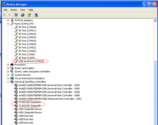

  • Hi Madan,
    Before you move on to resolving the computer host side, I just want to make sure that you've gotten everything right as far as windows.  When you plug in the Docking Station you should see something like the below.  Note COM16.  This is what you'd use to interact with hyperterminal or similar application on your computer.
    The next step would be to get both sides talking to prove things out.  The Code Composer Studio project sci_echoback in controlSUITE would be what I'd use:

  • Hi Brett,
    In my PC's Device manager also it is showing in a similar manner.
    Ports --> USB Serial Port (COM6)
    Universal Serial Bus controllers --> TI XDS100 ChannelA
                                                               --> TI XDS100 ChannelB

  • Madan,
    Great! Then hardware-wise/Windows-driver-wise you should be in good shape.  On your PC you'll use COM6 to communicate to the C2000 device.
    The sci_echoback CCS project, once loaded and run in the 'F28069, will retransmit whatever data it receives.  This will allow you to prove that the physical interface is working as you expect.  Once you get that working, you can then develop a more advanced protocol based on the needs of your project.  If you want to use Excel VBA you'd need to configure the SCI port via registers in the 'F28069 and the Excel VBA settings accordingly.
    There are several good hyperterminal programs (including free ones) that should be able to provide the functionality of hyperterminal.  I happen to know that there is a hyperterminal program named 'Terminal' within CCS.  View->Other...->Terminal.  I must admit that I haven't used it though.
