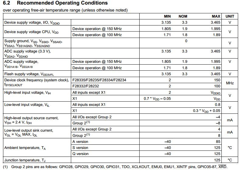

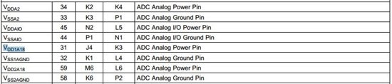

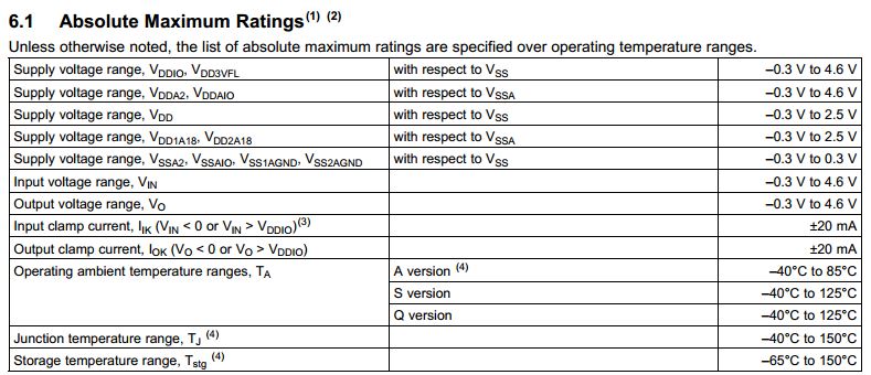

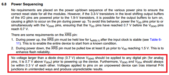

I have a question by the treatment of ADCREFIN at the time of power up of TMS320F28235.
Before Vdd1a18, Vdd2a18, and Vdda2 are supplied, even if precision source is supplied to ADCREFIN, doesn't a problem occur in device?
