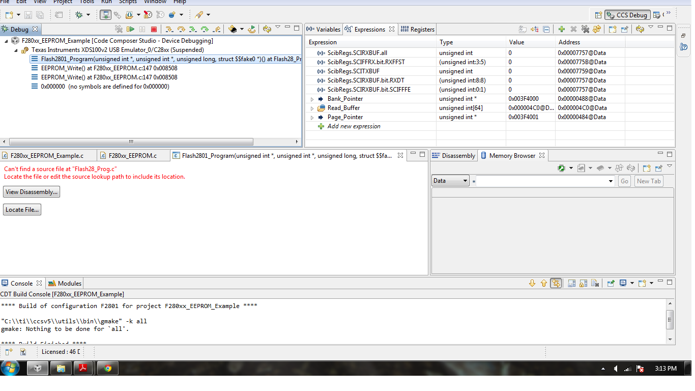

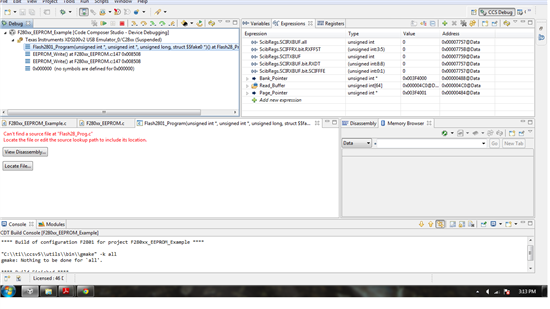

1) EEPROM emulation on Flash for SM320f2808
In the Example Code there are two functions EEPROM Write and EEPROM Read.
Inside EEPROM_write() function there is another function Flash_program().At the time of debugging  when the control comes to this point the error occurs.The screen shot of the Error is attached to this mail. Please find the example code here:http://www.ti.com/mcu/docs/litabsmultiplefilelist.tsp?sectionId=96&tabId=1502&literatureNumber=sprab69&docCategoryId=1&familyId=1414

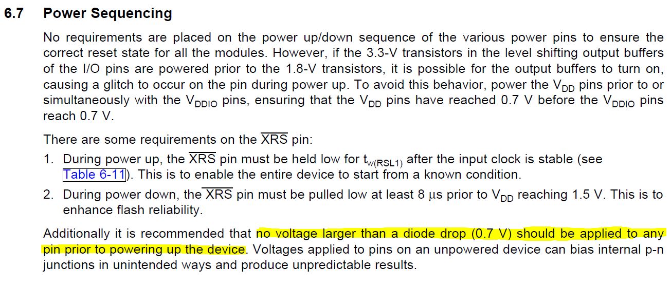

2) Power sequencing aspects for SM320f2808, the controller is not responding if the system is turned on first before the controller turns on, but works fine if the controller is turned on first.
Please let us know what could be the issue.
