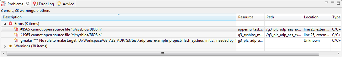

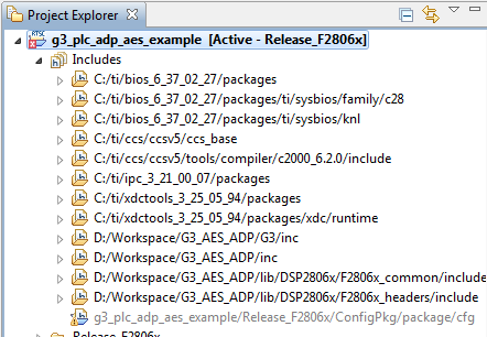

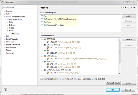

I'm working on plc example codes (g3_plc_adp_aes_example). I think I install bios and IPC on the project but the project does not compile. Also I couldn't find the "flash_sysbios_init.c"
It seem one or more file I have to add to project but I couldn't solve the problem.
Screen captures of error messages, includes and product screen.
