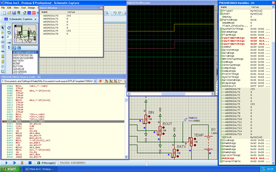

Hi
I am having a problem getting to simulate spam on f28027. If I provide an TBPRD value of 1500, when I simulate I only get a maximum value of 220. values are getting clipped @255. Also the ADC result register is getting clipped @255. for a 1.65 volt input at ADC pin, ADC Result only shows  255. whereas it should be 2048
Don't have clue why it is only 8 bit?
Will be grateful to receive some advice.
    Yes, maximum value ie for 3V it should be 4096. Can you share your code esp. your ADC configuration and fetching your result register? Also, I would like you to try the sample ADC and PWM peograms present in controlSuite.
    Do keep us informed.
    Gautam
  • Thanks for quick reply. I am using DP library template for 2802x and getting guide from dp library user guide in control suite to write my code to generate SPWM.
    thanks

    If you put ADC result register, for example AdcResult.ADCRESULT1, into watch window, what is the result?
    Can you give the screenshot?
    Maria
  • Hello, for an input voltage of 1.64982 at the ADCINB2 and corresponding SOC5, the ADCRESULT5=255.
    Which should be 2047/2048. an screenshot is given for your convenience.
    Thanls
    I have never used Proteus 8 for simulating Piccolo.
    I feel like maybe there is bug on the modelling of PIccolo device in Proteus.
    Do you have any F28027 kit (for example LAUNCHXL-F28027) to try to read these ADC values using CCS?
    Also can you try this simulation using ControlSuite example for ADC (or using other simple ADC code)?
    Maria
  • Hi
    Thanks for the suggestion. May be you are right.
    Unfortunately, the place I live these kits are not available locally. Since I don't have an international card, I am unable to buy right now.
    I will try your suggestion. Do you have any recommendation for simulation software?
    thanks
    Here's how you can perform simulation: http://e2e.ti.com/support/microcontrollers/c2000/f/171/t/98887.aspx
    Gautam
