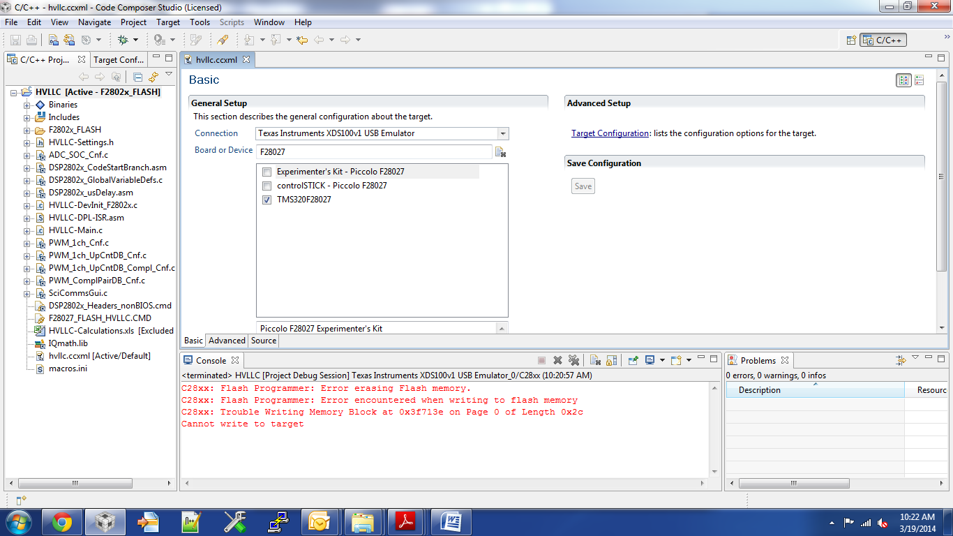

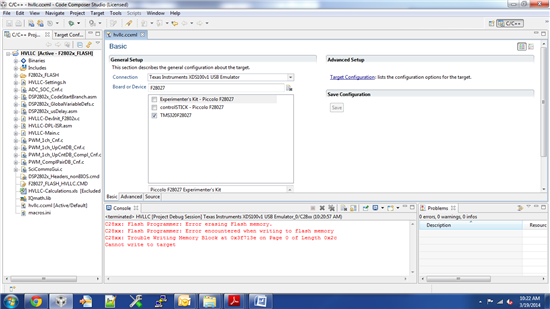

I then proceeded to import the project and create the new target (using CC  Version: 4.2.1.00004) to run it.

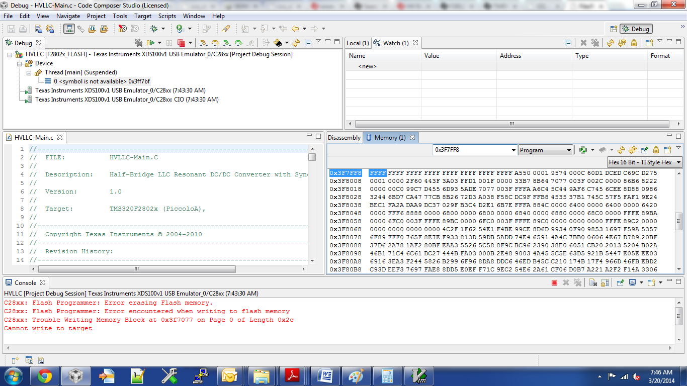

I try to debug the project and I get the Flash programming errors in the screen shot above (see red).

  • Thanks for the response Gautam.  None of the components on the board feel particular hot.  I will look at voltages.  Any in particular?  Any other thoughts?
    One other thing.  I do NOT think I bricked the flash.  Below is a capture of the pass word section.
    If I can't resolve this, I may just create a RAM target for the LLC kit  (not sure why it did not come with one) so I can start playing with the code.
